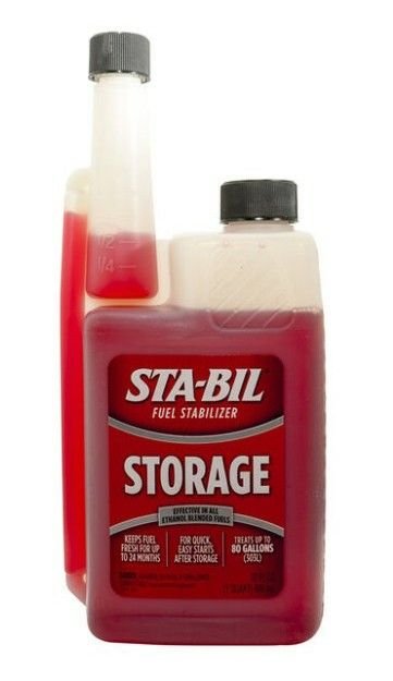

Several forum members have suggested the use of Sta-Bil fuel additive for winterizing. The bottle in which Sta-Bil is shipped is not user friendly in the least for measuring. I have found a measuring glass (intended for measuring espresso coffee) which is perfect for this purpose. The glass measures 2 oz (60 ml) which is what Sta-Bil recommends for 5 gal of gas.
I just purchased a bottle of Sta-Bil a few days ago. The bottle has a built in measuring chamber with graduation lines. Simply loosen/remove the left cap, and squeeze the bottle until the desired amount fills the chamber. No need to use a separate measuring glass.
