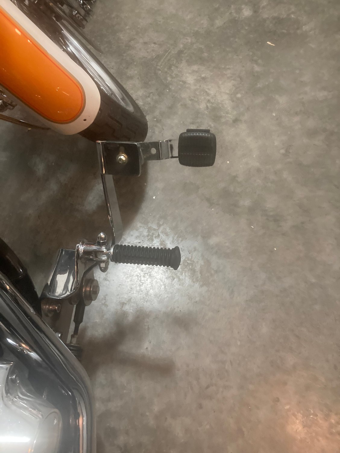

Due to various injuries I am pretty much gimped up on my right side from my neck down to the tips of my toes. Fortunately I am still able to pull a trigger and withstand a moderate amount of recoil,
But I digress.
As a result of my injuries, my right foot is always cocked out at about a 30 degree angle. That has made it difficult for me to activate my rear brake.
I've just been living with it for a long time now until a couple of days ago.
I was digging around in one of my spare **** bins and came across a passenger seat attachment bracket and a couple of spacers.
That got me to thinking.
I've always been a function over form kind of guy so what it looks like, matters not to me. As long as it works, I'm a happy camper.
I used the bracket to extend my brake pedal down and outward to where I can ride with my foot on the peg and now instead of having to use my heel on the pedal, I can simply **** my foot froward to activate the brake.

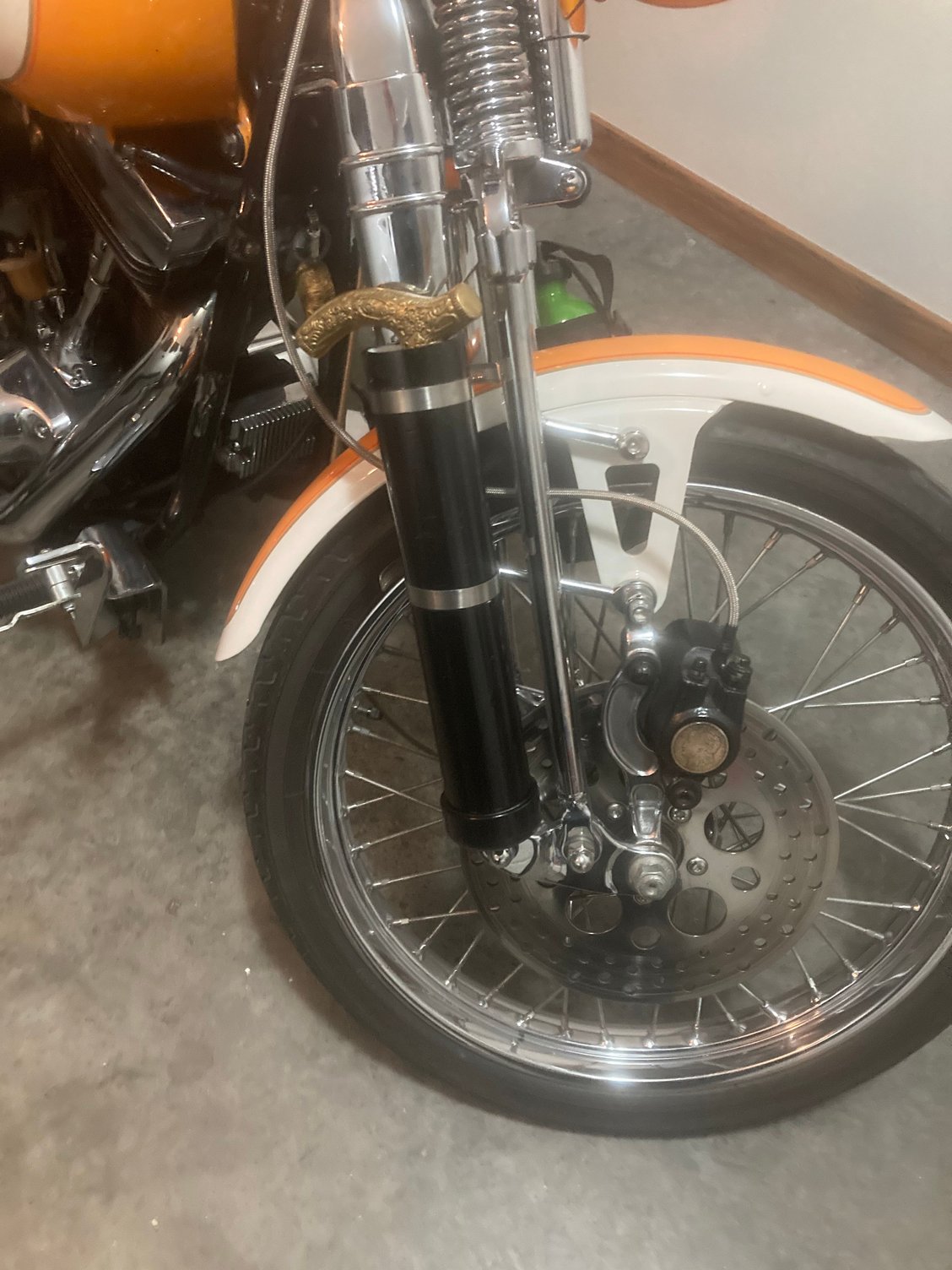

I also like to carry a cane with me wherever I go. I don't always need it but, If do, I really need it.
I cut off a piece of PVC pipe, capped it and used a couple of hose clamps to secure it to my rigid front fork leg and now I have a carrier for my 3 piece wooden cane that my late Step Father (RIP) had forever.
Both things I made were from **** I had laying around the house and didn't cost me a cent . The PVC was in my shed when we bought the house and I can't even remember where I got the spacers from. The seat bracket come off of one of my old bikes.

The brake bracket looks a bit on the weak side. I can see it bending after a few uses, or a panic stop.
Think about using something more stout. Please.

20323854[/url]]The brake bracket looks a bit on the weak side. I can see it bending after a few uses, or a panic stop.
Trust me. You’d need a vice and a BFH to bend that seat bracket.

Just throwing this out there. Might not be wide enough. I’m pretty sure this is a Kuryakyn offering. I did this when I installed their extended brake lever because I was getting tangled up in the air cleaner. Extended brake lever pad, and you can install other center pads. Foot board is off while I complete an exhaust install.
FWIW, Soft brake makes a 1" offset brake lever (offset to the right) to use with foot board spacers which I am also running. Using the offset brake lever and the extended brake lever pad would give you 2” offset (if the two parts fit each other).

Its a shame to cover up the beautiful springer, Maybe mount something in the rear of the bike, also break peddle looks week, maybe heaver piece of medal?

Ha, missed the cane holder, hope you have a hole in the bottom for drain purpose !
Yes I do.
