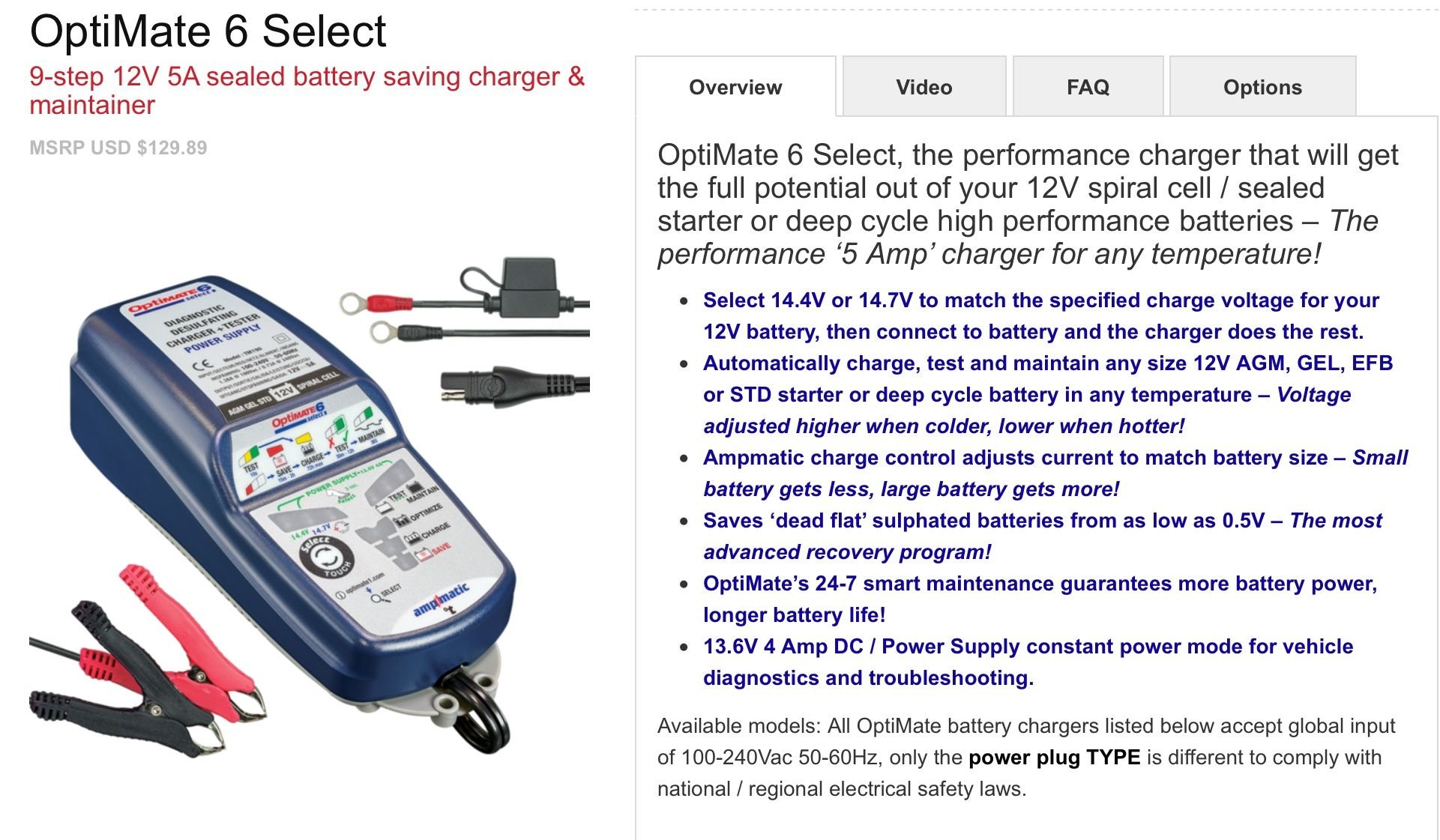

You need the right charger/maintainer.

Some chargers like the optimate have a specific mode to get flat batteries going again.
I think for most motorcycle batteries 5 amps might be too high. I have seen other chargers that has a car and bike mode and the difference is to lower the charge amperage.
Yuasa only recommends 3 amps for their batteries - Motorcyle battery charging and discharging information guide (yuasa.co.uk)

5 amps is the max, read the text.

The text from Yuasa states 3 Amps, "When charging a motorcycle or other small battery, the battery charger should not exceed 3 amps."
Yes the Optimate can charge at 5 amps. I didn't dispute that I just used the information from Yuasa to state that might be too high. It also states it has Ampmatic control to reduce charging current for small batteries which I have just noticed.

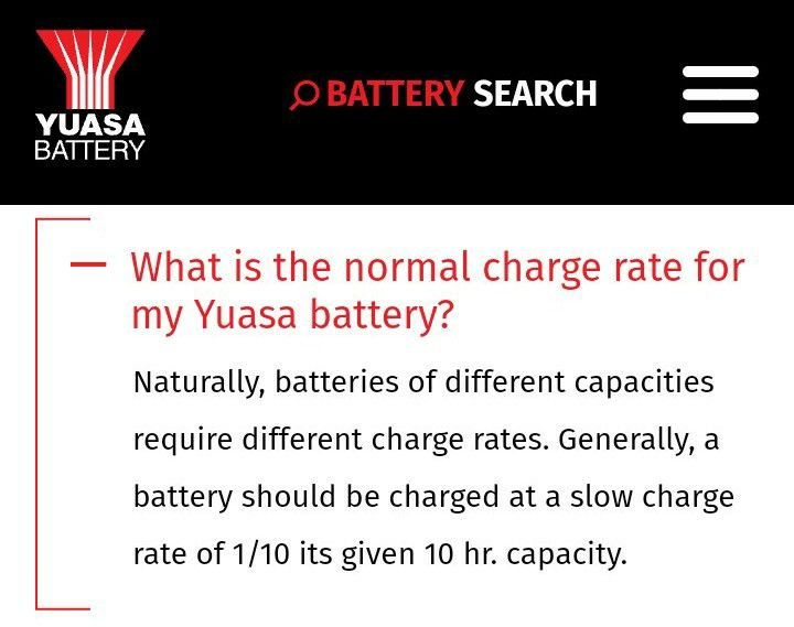

That may have been the case when Yuasa's top of the line motorcycle battery was rated at 30 Ah, they've since upped their game to 32 Ah. It's not much, but a 3.2 amp charge rate certainly exceeds the outdated 3 amp max limit from the past. This is what Yuasa has always reccomended.
Seems to coincide with the charge rate displayed on their latest and greatest.
