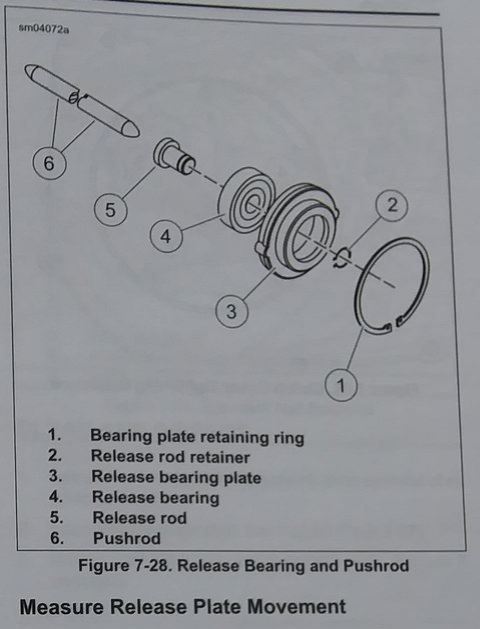

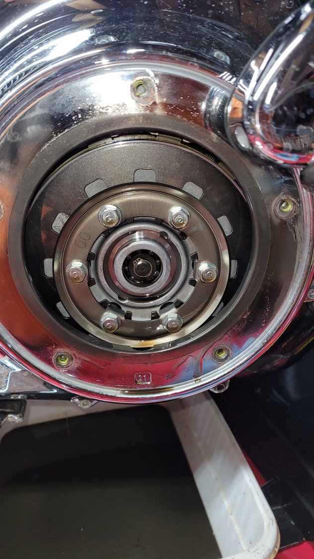

The push rod is between the clutch actuator cylinder and the clutch hub, The rest is behind the derby cover.

The schematic is what you will see if you take the derby cover off.

Made since after I removed the dirby cover. Thank you for sending me in the right direction.
