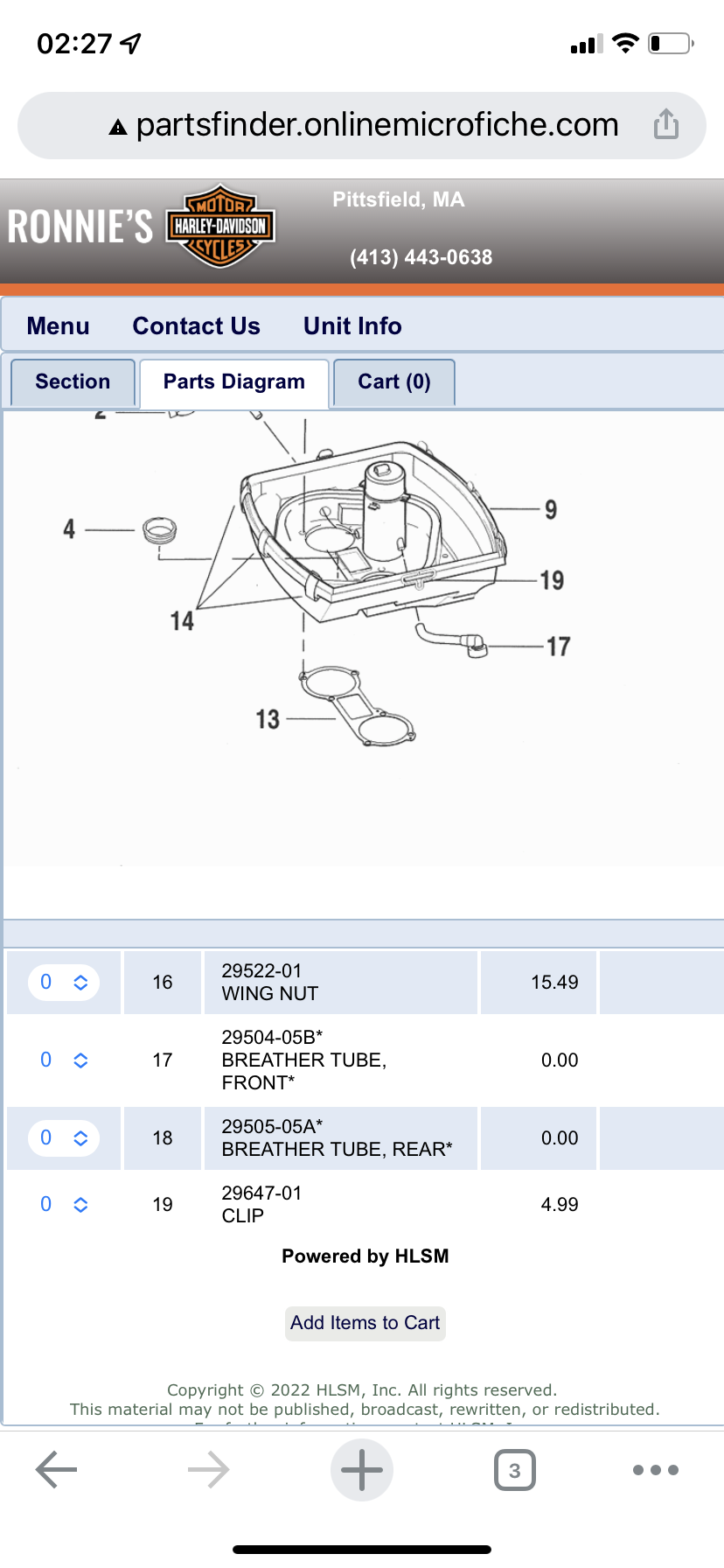

If it started when you had problems after removing your air filter, I’d change your breather tubes they’re cheap.
This is for a 2014.
http://partsfinder.onlinemicrofiche....odelyear=2014#

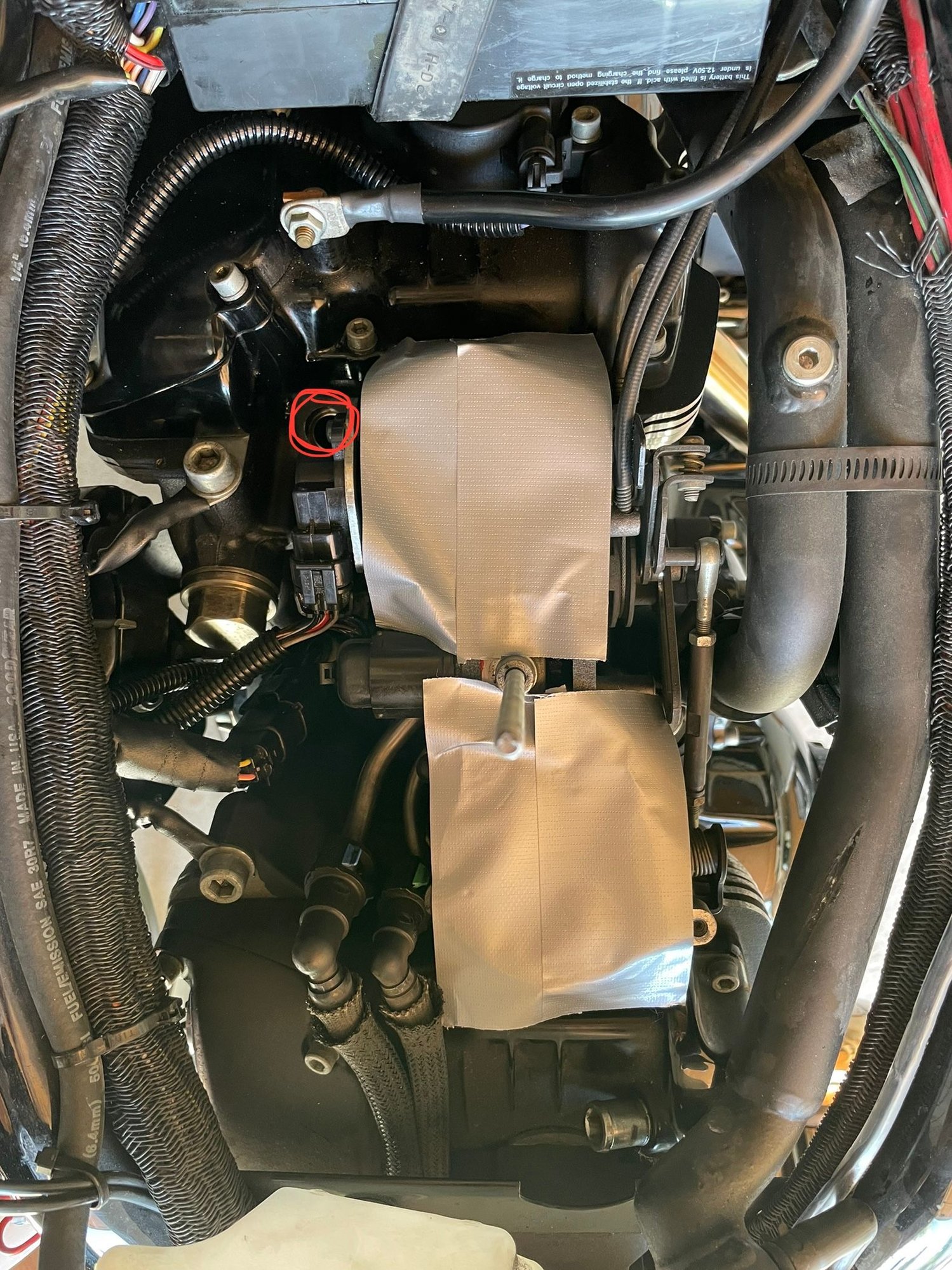

It did work before i removed and re-installed it. Still think the tube might be the failing part?
I've attached a photo where i marked the spot on the engine where the oil came out.
its a cooper pipe with a rubber sealing that goes in that hole. And then the tube from the airfilter housing slides on that cooper piece.
