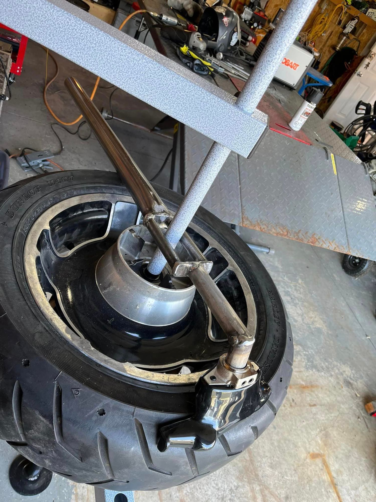

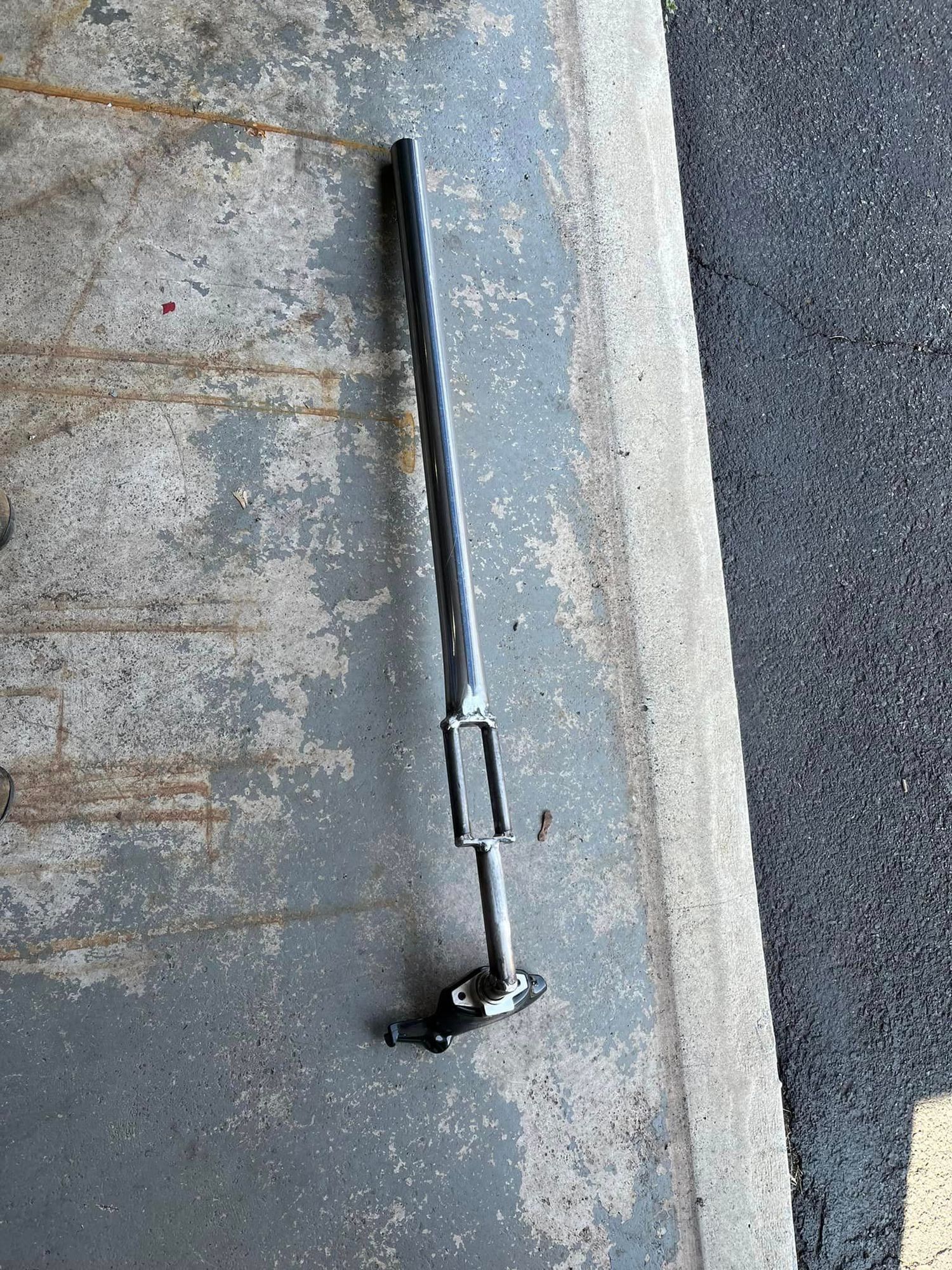

No wonder I couldn't find it on the Forum, it was a Face Book post. @LQQK_OUT
This was by Barry MacLean:
"The overall length is 43 inches..the twin bars are 3/4 inch solid round bar 5 inches long...welded to 1 inch by 1/4 flat bar 2 1/2 inches long...I spaced the bars 1 1/8 apart to allow it to slide over the 1 1/16 nomar centre pole. I used heavywall 1 inch pipe 6 1/2 inches long to angled part...angled pipe to tip is 2 1/2 inches long...I winged the angle...not sure of the exact angle...but eye balled it on my nomar machine before I welded. The main handle is 1 3/4 medium walled pipe 31 1/2 inches long...squished the end down in the vise to weld onto the 1 inch flat bar...46 inches of material length and angled for an overall length of 43 inches when standing straight up."
Duck head is 28mm..but a 30mm would fit as well...the 28mm fits perfect...any brand with the allen head screw attachment would do...I liked the solid body duckhead as opposed to the ones with the open space rim slide thingy."

Thank you for the follow-up. I saw that post in the Facebook "No-Mar Tire Changer Users" group and even commented in that thread that I was looking for a ratcheting duck head.
The problem I see with his design is that the bar has lots of "play" around the center post. Seems like the potential to scratch a rear sprocket or brake disk is very high. The ratcheting system on the Rabaconda doesn't have any free play on the center post.
I've also written to No-Mar with a product suggestion of a ratcheting duck head option for their manual tire changers.
