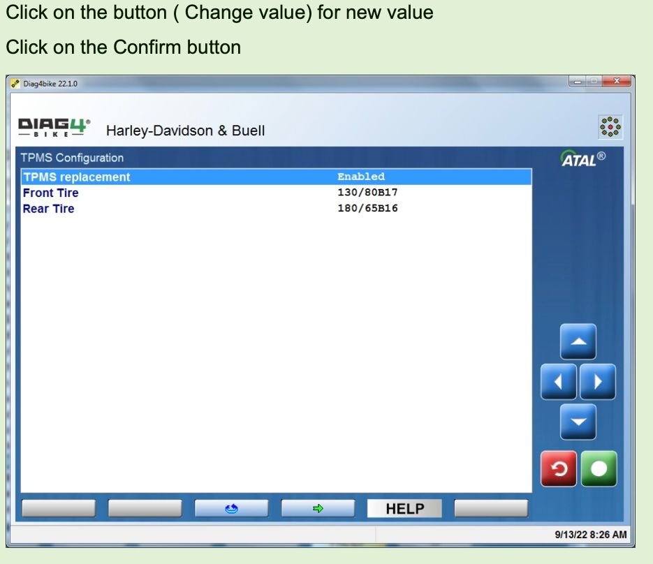

They don’t have different sensors for different size wheels… the sensors are all the same. Just be sure your new wheel has 8.3mm valve stem holes. But on the TPMS screen in the diagnostic software you can verify your bike’s tire size, have your shop update the info in the BCM and you should be good. Don’t buy any new sensors.

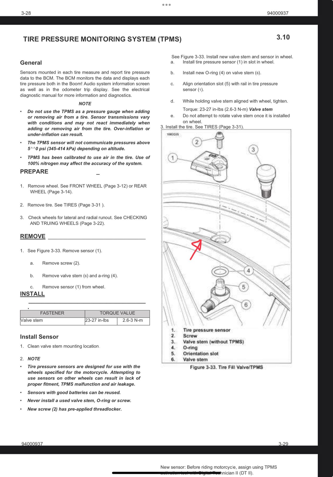

I do have another question: The Turbine wheel that i’ll be installing the sensors is non-TPMS, so it may not have the sensor slot (see image).
Would that be an issue? Is there a workaround in case I'm not able to position the sensor?

IF the slot in the wheels you are going to be using does not allow for sensor to sit inside the wheel you could use these valve stems and bracket. FWIW, I think the wheels will have a groove that will work...

As for wheel/tire size there is a place in the diagnostic software to enter the tire size when doing this

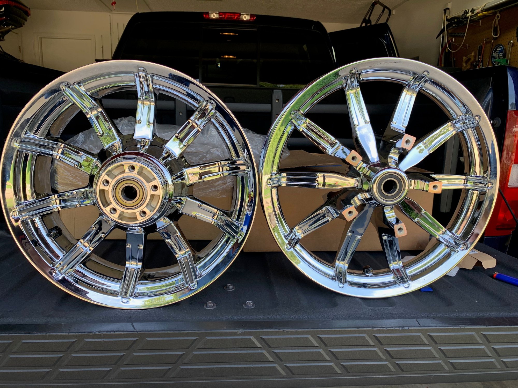

What size valve stem hole do those wheels have? HD wheels have 8.3mm holes or 11.4mm holes, and the TPMS valve stems are made for the wheels with 8.3mm holes. Even if your wheels have the 11.4mm holes there is a work around for that too. These are my '16 Impeller wheels (front wheel in picture) with the 11.4mm holes, just put a "FOBO" rubber bushing in the hole from the inside, basically adding another "seal"....
then mounted the valve stem and sensor to the wheel..... worked fine for a few years, and was still going strong when I traded that bike in
