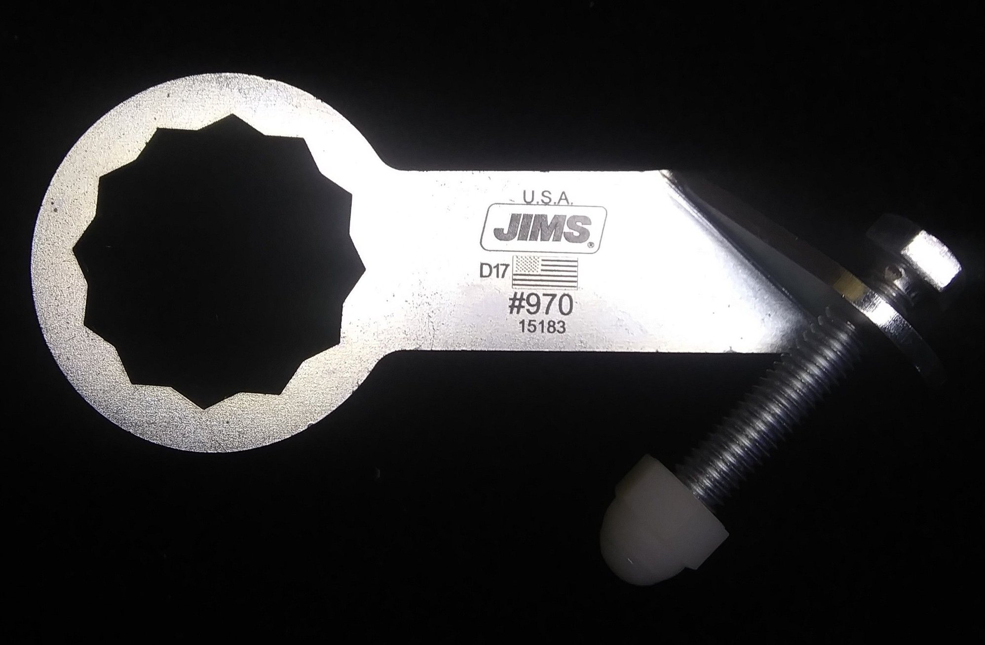

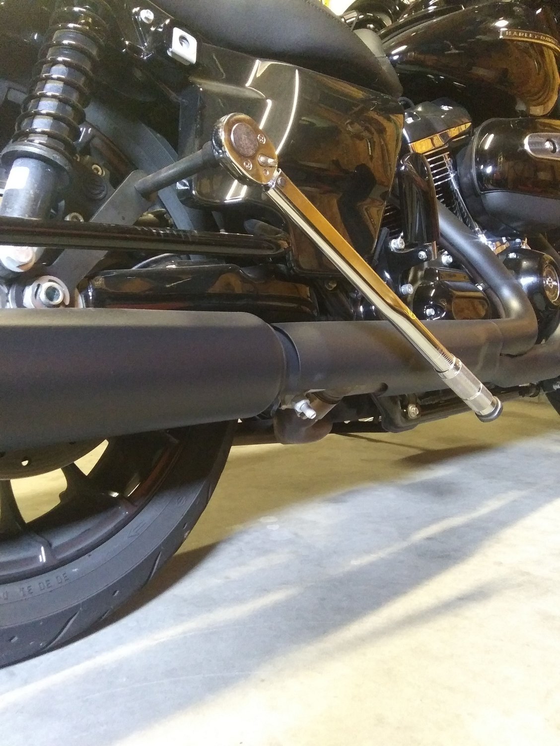

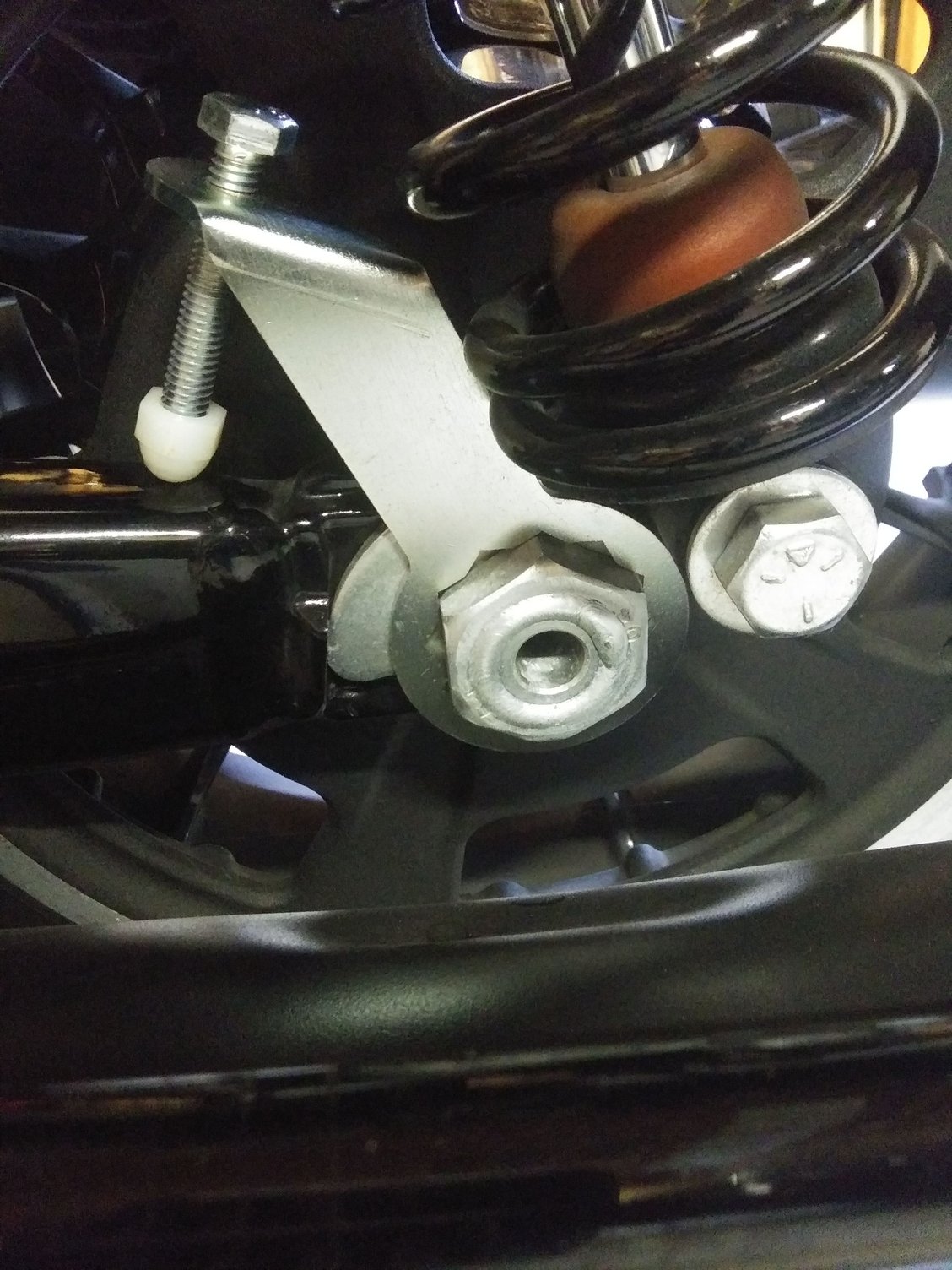

Maybe he was using this tool to hold the left side stationary. It's what I use.
It allows me to stand on the right side to torque the axle nut without worrying about the left side moving.
