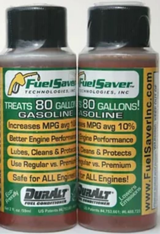

My buddy swears by Startron in carbed bikes.
I use this.
to each his own…
