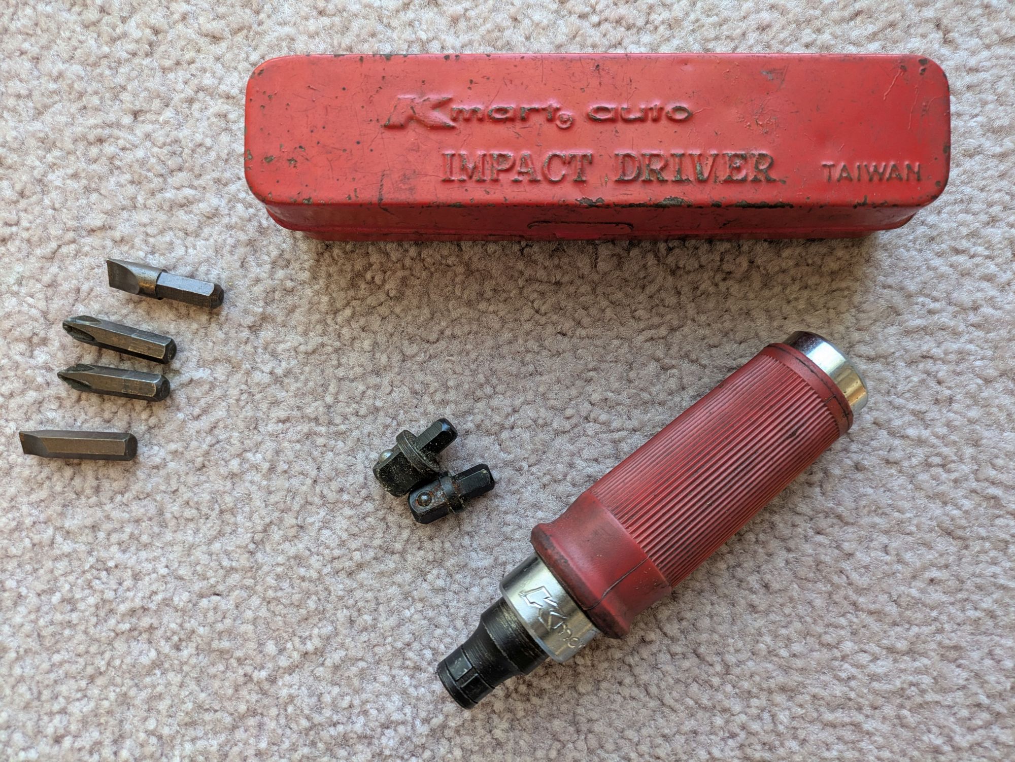

Oh Boy, tool show and tell! I've had this K-Mart impact driver maybe 40+ years. It's saved my butt quite a few times. Yes kids, at one time K-Mart had a good automotive section, now they have......no section! My pic:

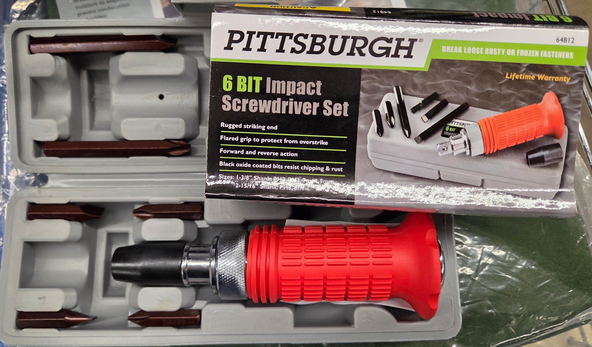

Very interesting thread, I learned a lot. Then I stopped at Harbor Freight on the way home tonight and bought this for $10. 😄
