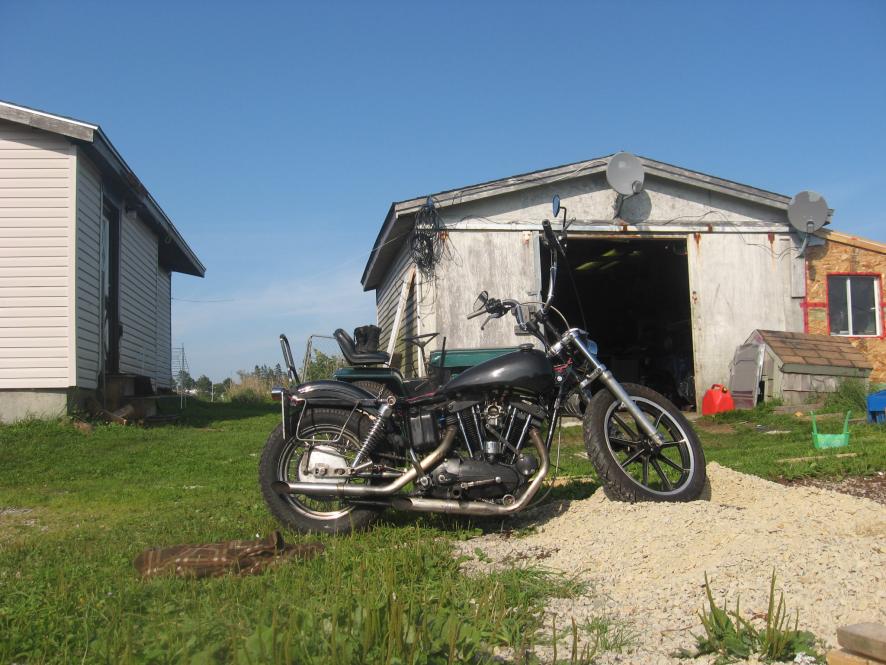

i can tell you from experience, that yes most parts especially the ones you listed are compatible in the majority of the sportster line up,
if you look at mine a 69 for example, i have rims from a 70's shovel head, carb from an 80's sportster, cables from 82-95, front brakes ro ma newer heitage, front forks from a new sportster, tank from a 90's sportster, controls from 90's, headlight housing from a 2000-up etc. sometime you got to modify things a little bit to fit but for the most part accessorys are compatible with bikes throughout the years.
