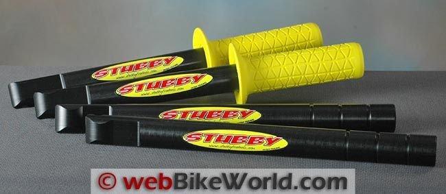

Stubby Pro: Black Grip Set
Our Original tire changing tool for your motorcycle. This revolutionary tire changing tool is made of a high quality plastic that won't scratch your rims and reduces pinched tubes!.It is the professional's choice! "It really works!"
Amazon.com: Stubby Pro Tire Tool Black Grip: Automotive Amazon.com: Stubby Pro Tire Tool Black Grip: Automotive
I use these to break the bead on the old tire (200 rear) and install the new one - the tip is shaped for breaking the bead and then flip them over to lever the bead off the rim. The material is tough and does not scratch the wheels.
I was quite surprised how easy this was to do on my own tire change, and if it wasn't that easy I'd just keep using CycleGear to change the tires.
Here's a good write-up:
http://www.webbikeworld.com/motorcyc...by-tire-tools/
