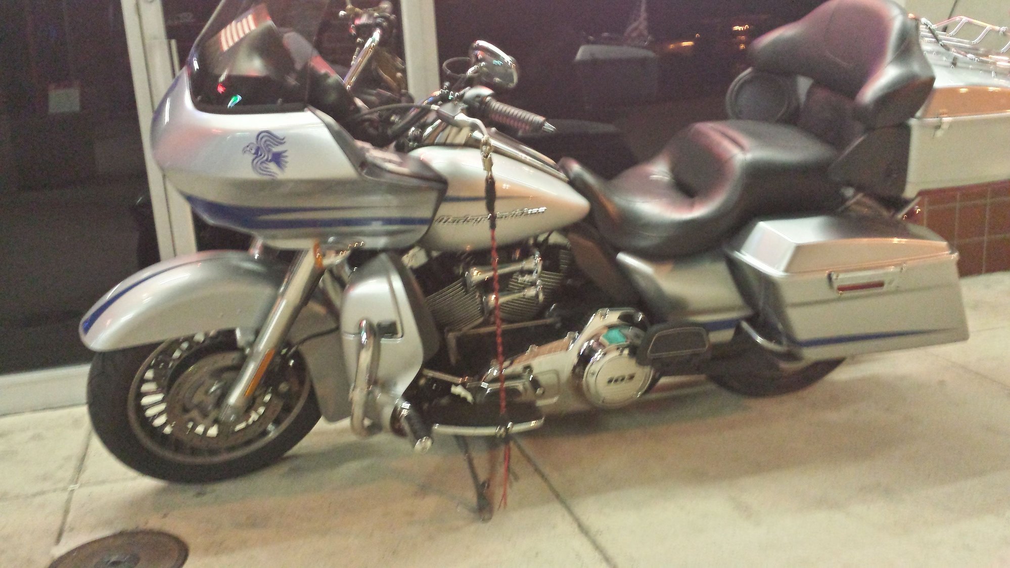

I'm mounting a set of Howards Horns on my FLTRU. Being an Ultra (with lowers), the "factory" mount is the 2 trumpets, with the cowbell hanging underneath (see first pic). I'm not digging that look, and as I was fiddling around, I noticed that the compressor (tightly) mounts under the left-side panel (in front of saddlebag....see pic 2) and cover fits over it with no interference, leaving a cleaner looking install. Has anyone ever tried this? Is there any issues I might encounter that says I should just leave it in stock location? The factory air hose is 1/4"x12"...With it mounted under the cover, I'll need 17" long.

As far as the mounting, I went ahead and hid the compressor, no problems whatsoever, much neater install than having the damn cowbell hanging under the trumpets
