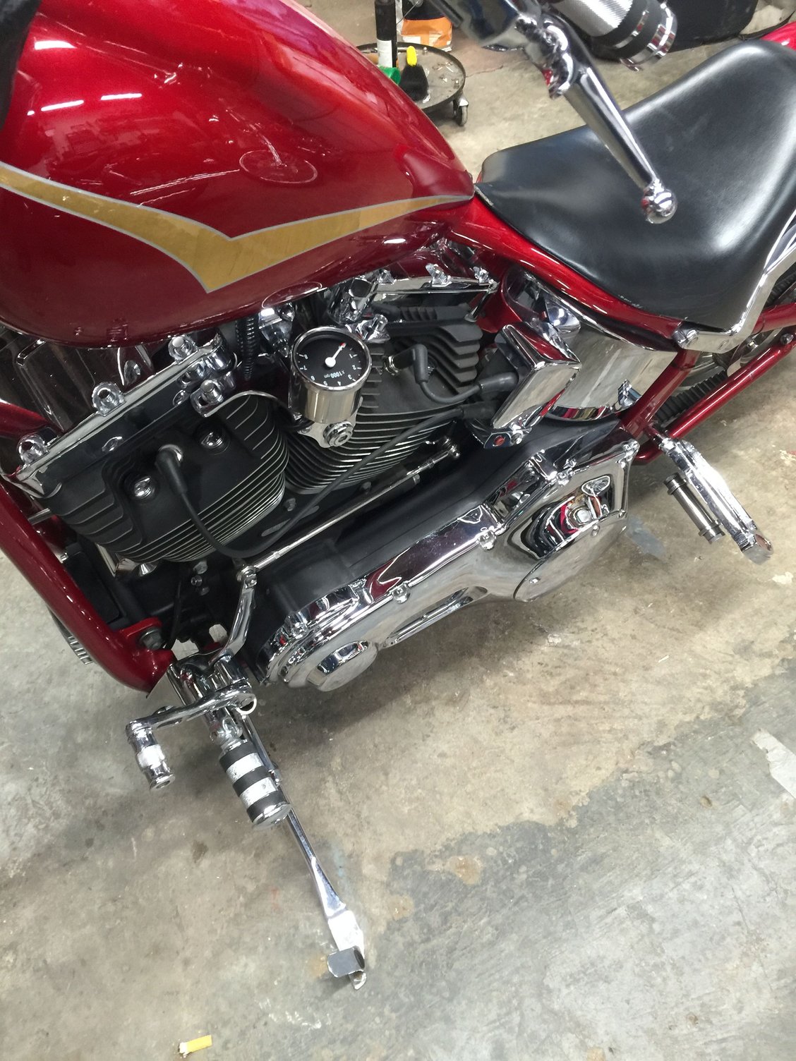

I wanted to install tach, I had to remove tank and found the wiring through frame really tight. barely able to fish a brazing rod down through top of frame to battery compartment, Put extra wiring into 2 long strips of shrink wrap and duct taped to end of rod. TIP-used a little bees wax on tape and wiring and it slid right on through, just like butter.
