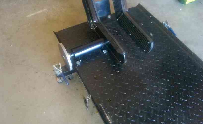

I prefer a wheel vice but it need to typically needs be modified. I removed the hand-wheel and made a knurled disk that you use your foot to open and close the clamp. That way you can open the vice all the way with your foot by simply spinning it with your foot. You can also close it quickly with a quick bump or 2, then drive it tighter with your foot while holding up the bike. I generally don't tie the bike down. I use a flat scissors jack under the frame to hold the bike upright..
This was Rev A.. Rev B is smaller and wider so you can hey a bit more velocity on the spin..
