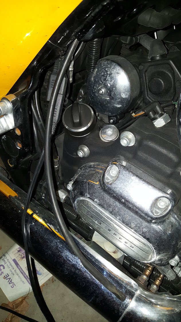

On my 2013 Street Glide, the is a hollow tube coming down on the right side of bike that has nothing in it. The tube is loose, and not cable tied to anything.
See pic?
What is this tube?

Vent off of your fuel tank. I have one on each side. You probably do too.

Thanks. Was not sure. I will just cable tie it loosely. Seems to be getting to close to exhaust.

Stick it inside of the frame rail to keep away from exhaust. This photo is from when I was doing work on the bike to keep track of where things go, but it shows how far back it is normally.
