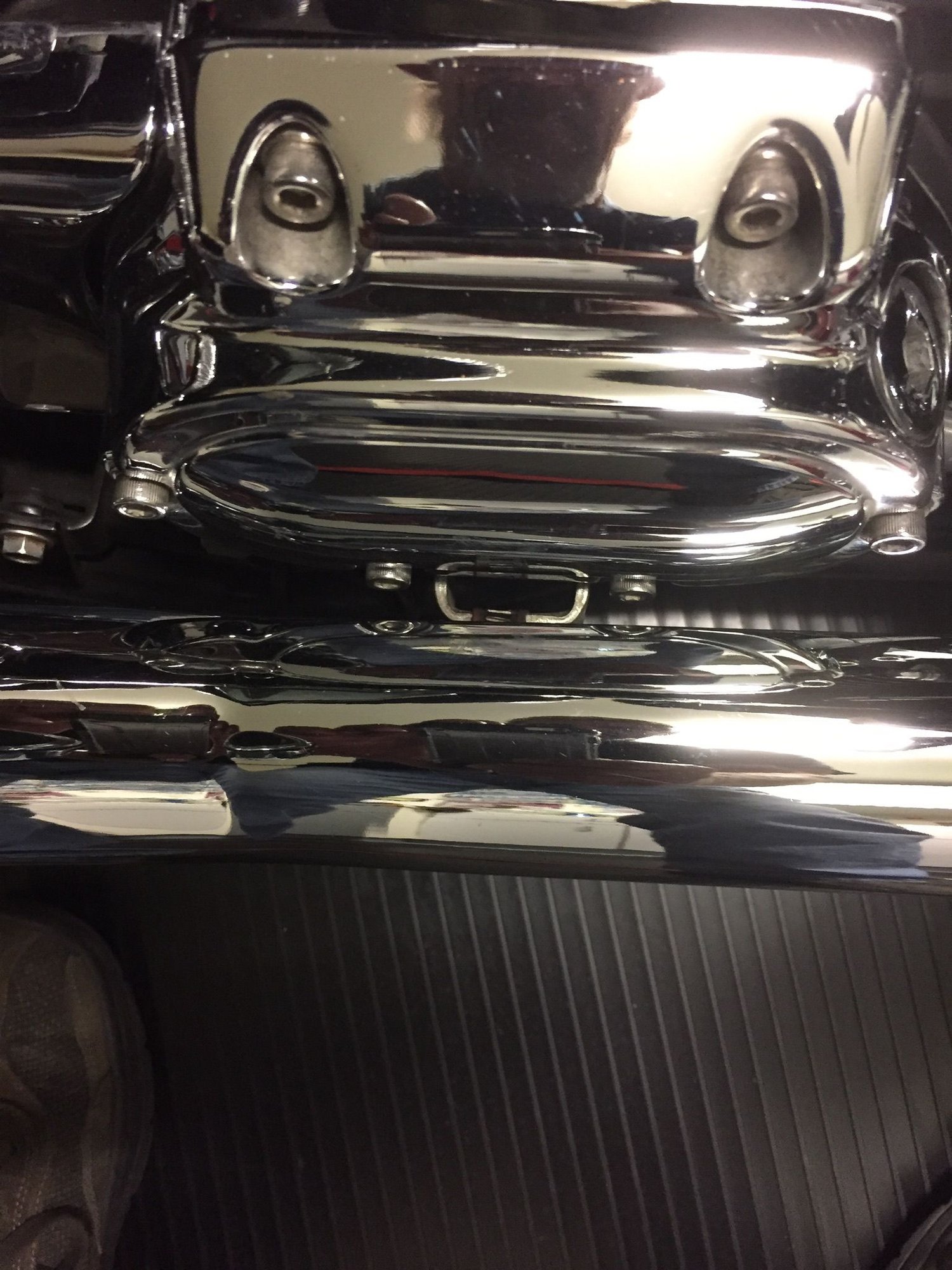

Update after a hour with the bike on the jack trying to find the noise! Found a brace under the tranny next to the exhaust pipe so put a clamp around the pipe and brace. Went for a short ride and as far as I can tell no more irritating noise!
What a simple fix!
