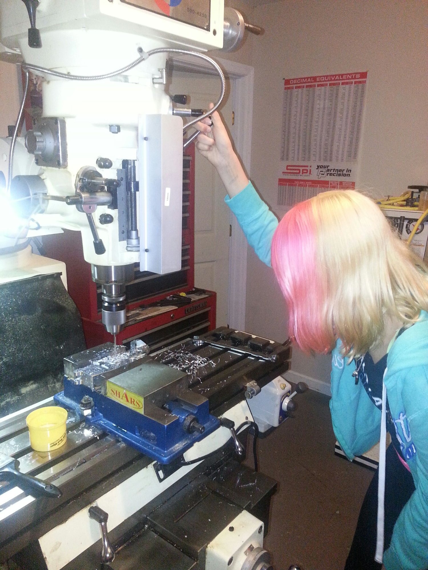

My little shop and my GD machining
holes in a receiver. In her third week of college. She wants to be a nurse. I think she ought to be a Brain Surgeon...

Quite some 'little shop' - and a jolly fine GD too!
