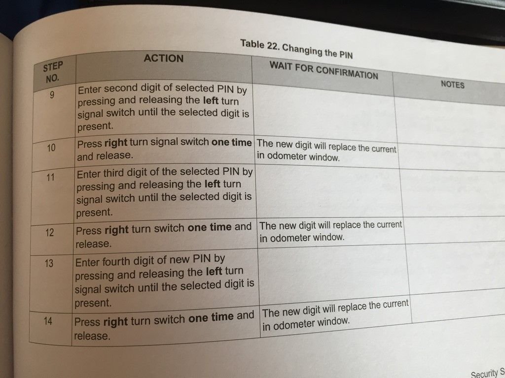

Yes, it's a securitysystem on ofcourse. Ive followed all instructions in the manual, but I can't enter the five digit change section. Yes I have a fob.
Old Oct 22, 2018 | 08:22 AM
CoolBreeze3646's Avatar
CoolBreeze3646
Joined: Aug 2006
Posts: 24,570
Likes: 30,924
From: Pennsylvania

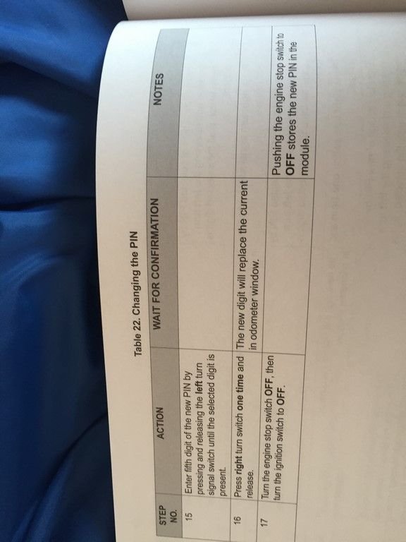

Those instructions are if you know the code and the FOB is not present. In order to change the code you need to go to the "Changing the PIN" section of your owner's manual (Page 119 in my manual).
See attached listed PDF or images below.
