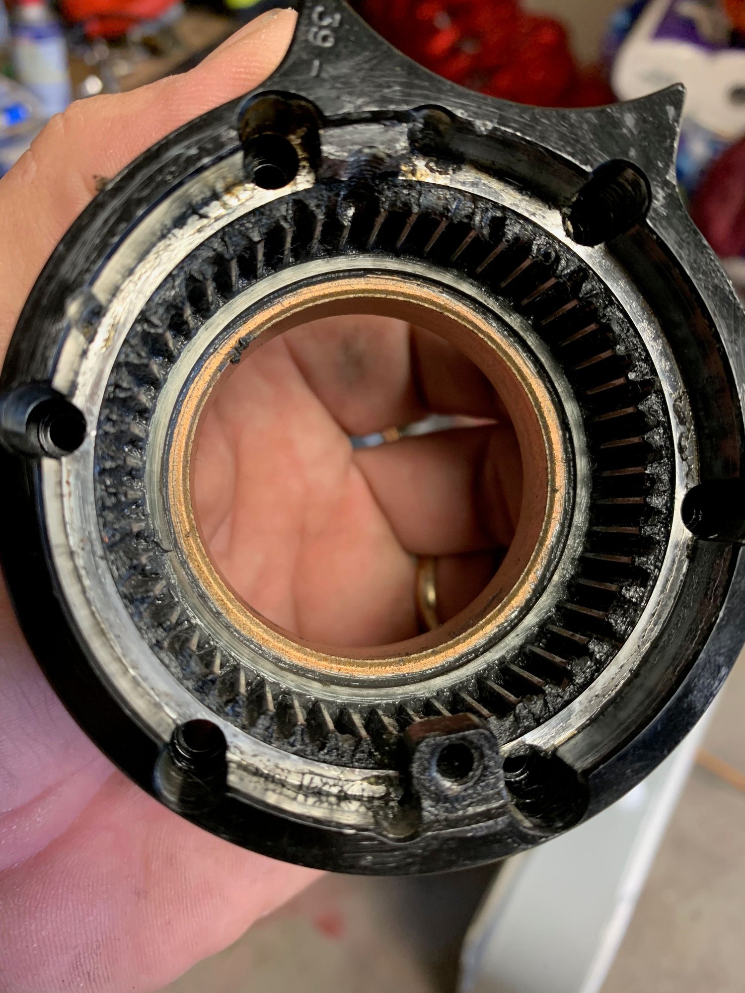

I have a 2015 FLRT and my reverse broke, does anyone know of a good source for parts? My problem is where the motor bolts on to the assembly by the sun gears one of the two tabs is broken.

Here is the problem

No, the motor bolts on with 2 #10 allen head bolts, the tabs is what the motor bolts thread into.

ok, thought it was a mechanical reverse. looked at the parts fiche and hd does not offer parts other than a complete assy at well over 1000 dollars.
what you could try doing is cleaning the base very well and then have it built up via a tig process and then shape and tap.
is the outer gear material steel? if so, is it pressed in or casted in? would be expensive but you could have a cnc shop make a housing out of aircraft grade aluminum. it would be fairly easy since you have a pattern, the old part. they put the machine into learning mode and generate a numerical pattern. then you could offer to sell them to recoup costs.

Ok so this is what my machine shop came up with, now all that's left is to assemble and test it out.
