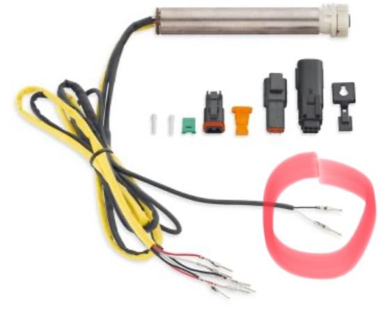

If that’s the case, just leave the wiring and everything in the bars and change out the grips. Cut the wiring at the grip and pop them off. You’ll still want to unplug the connectors under the fairing. The right side has the wiring with the twist grip sensor so if you were to pull it out through, those would stay in anyway. Just best to leave both sides in there. The wires with the TBW aren’t used with bikes that don’t have heated grips so no issue leaving that alone. You can see it circled in the pic.
