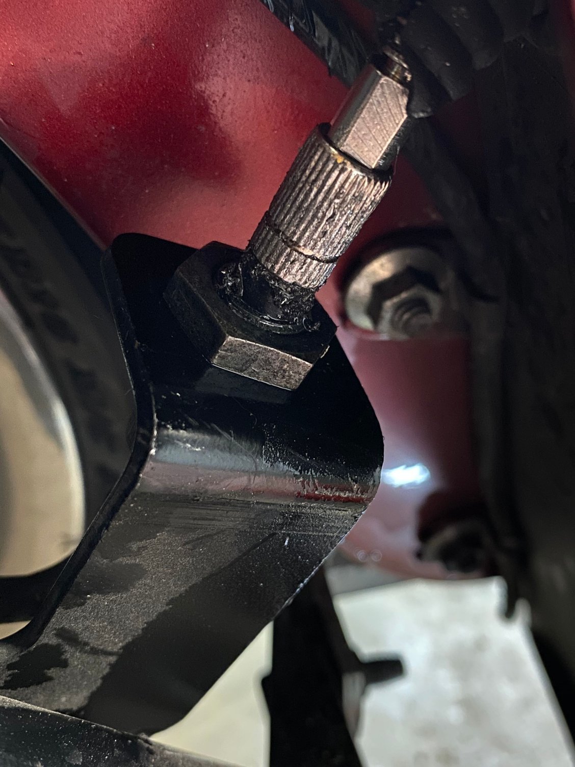

I have read previous posts and can’t find a result. Like other, trying to remove the factory whip stereo antenna. It just spins and spins. There is NO set screw. Any ideas
The silver just spins
