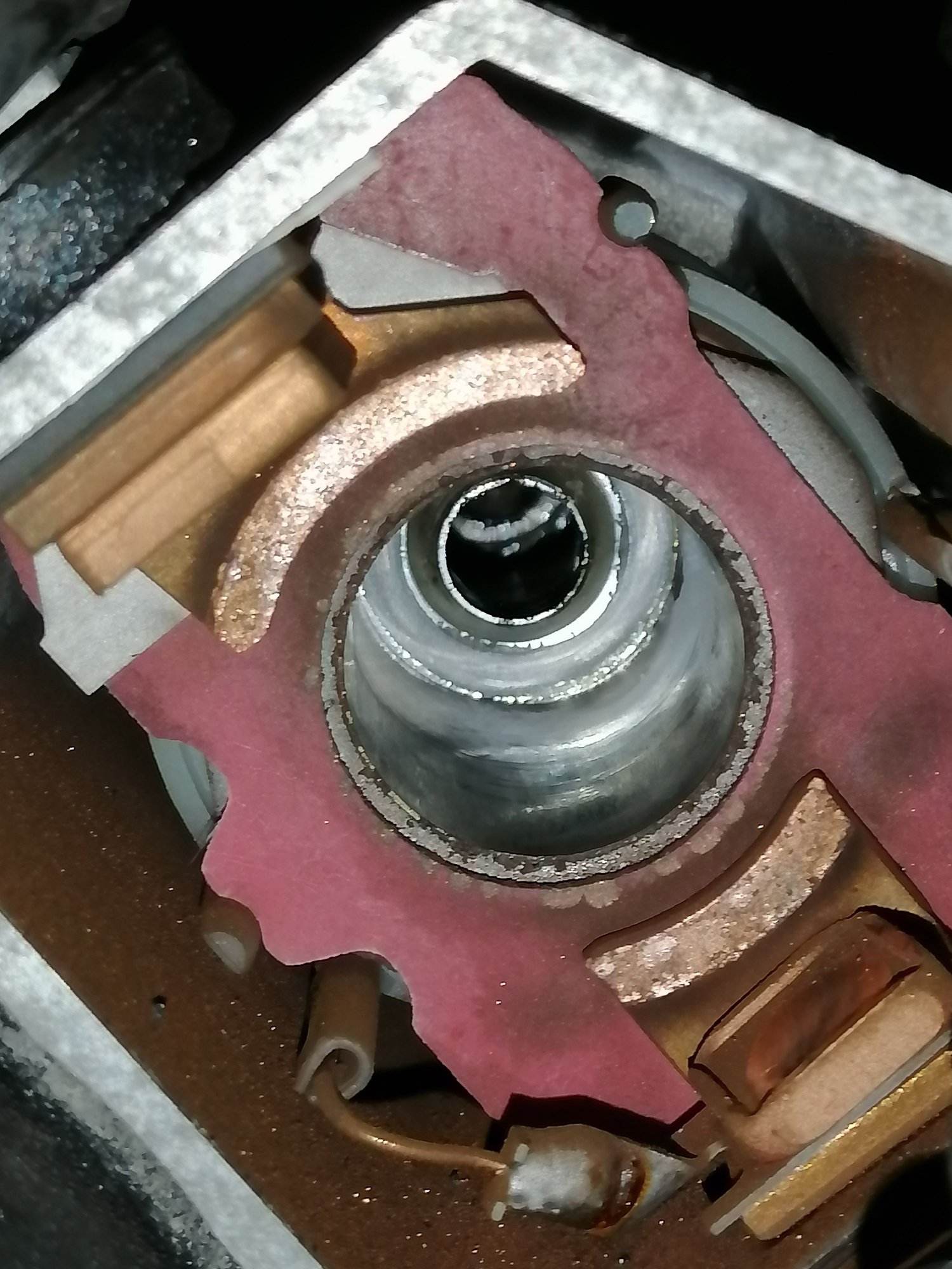

Have cleaned all the connections i not got my multimeter on me,, i took solinoid apart and found this,, what yr thoughts

Judging by the pic , it does look pretty rough . Since you have it apart , replacing those parts would be wise , not very expensive . You could also remove those parts and try cleaning the mating surface with a fine file , finishing up with some very fine wet / dry sandpaper . You definitely want both mating surfaces to be smooth , so when they mate , you get a solid contact . Usually , a bad surface is the result of a weak current going to it , causing the plunger to rattle / bounce , which causes arc welding on the two surfaces .
