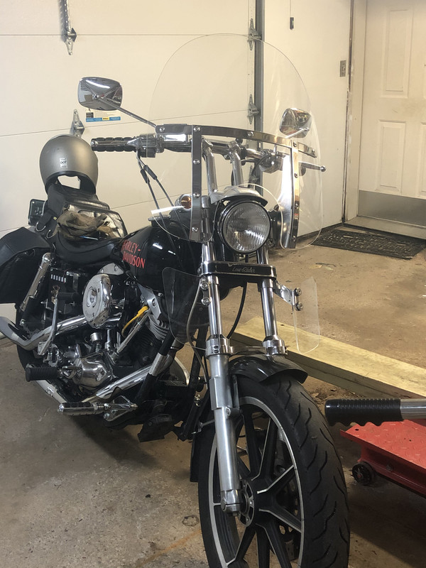

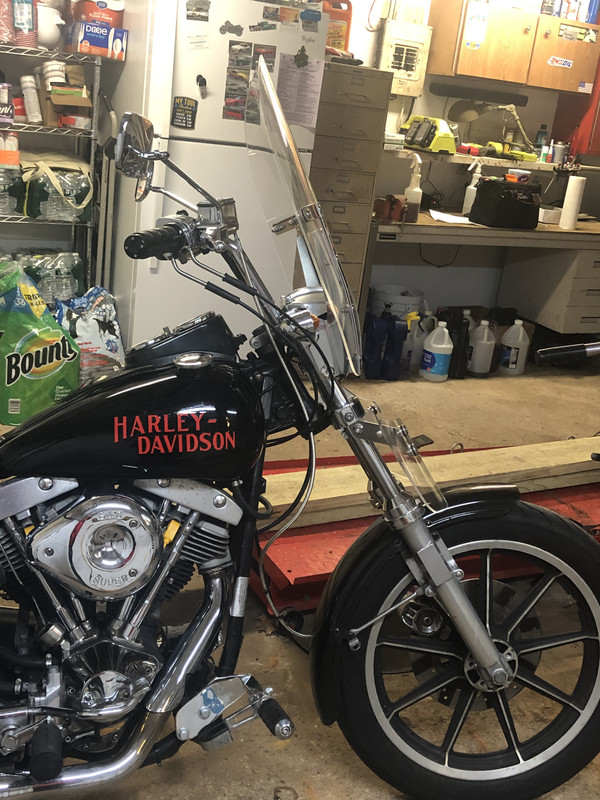

I know this has been covered before. I understand ideally you do NOT want to be looking thru a windshield on a motorcycle but above it. I know wind often comes up from underneath causing a lot of buffeting which lower should help with.
I installed a Memphis Shades Fats 17" windshield. Installed it on my 84' FXSB Shovelhead. I set it up so the top edge of the windshield is roughly at the bridge of my nose.
I wear a Biltwell Lanesplitter helmet which is a full face.
Above 45 mph or so I get the buffeting which affects my vision (no good!). I tried lowering the windshield which seems to make it worse. Tilting it back makes it worse. It seems having it as high up as possible (looking thru it) and most upright lessens the buffeting although it is still there.

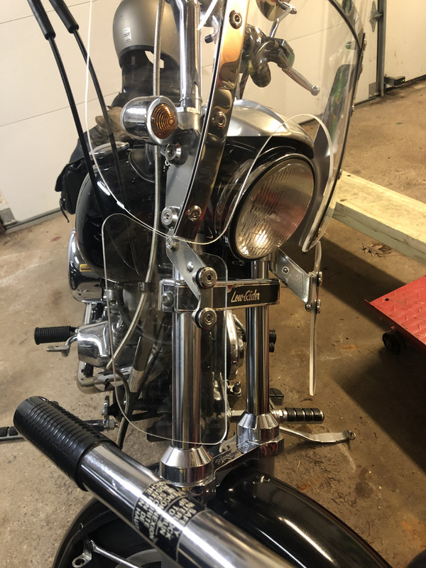

Next I installed the Memphis Shades lowers. Not much improvement if any.
I haven't tried going for a ride w/o a helmet to see if the buffeting goes away but I need to wear one.
Any suggestions?

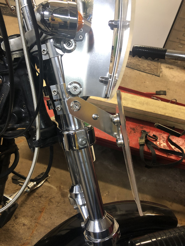

Maybe try to raise the windshield lower mounts to above the lower triple tree, to close the gap between the windshield and the lowers?

Next time you head out for a ride , place your hand beside your tank , you'll no doubt feel a bunch of air coming up through that gap , I think G.Q.R nailed it , the way those lowers are set up , your not getting proper deflection . You should be able to raise the lowers and leave about a 1/2" gap between it and the windshield .

I agree MyFav.... next ride and you get buffeting, place you arm horizontally across your chest. If this helps reduce buffeting, the wind is from below. If not, wind may be from side or top. I had buffeting on my Street Glide and put the fangs on. Hate the looks, but enjoy the no buffet of the head. Good luck on your journey.

I raised the lowers up to close the gap with the windshield. I don't like how there is no adjustability to match the angle of the windshield. With the lowers all the adjustability is in the clamp only.
Hoping to get a short test ride in today. I will try the arm across the chest test too.
