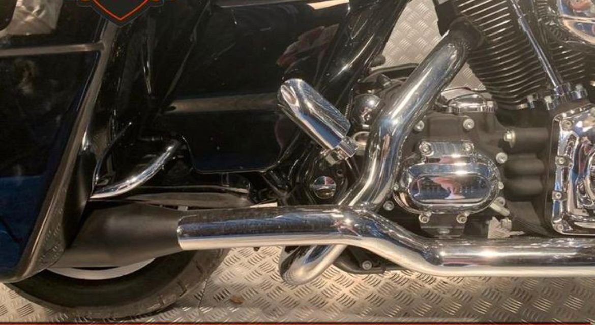

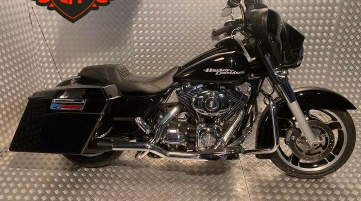

Can I place Samson fishtails slip-ons or another brand on this exhaust? They are true duals (Rhinhart Racing exhaust)

Yes, IF your head pipes are 1 3/4 " O.D.

Head pipes are O.D. because they are "Male"
Slip ons are I.D. because they are "female'
STOCK twin cam head pipes are 1.3/4 O.D.
Most aftermarket slips on are made to do just that, SLIP ON, therefore they are 1 3/4 I.D.
I do not know the diameter of your Rinehart head pipes.
MEASURE them , look at the specs for the slip ons you wish to purchase
MOST for Twin Cams are 1 3/4"
