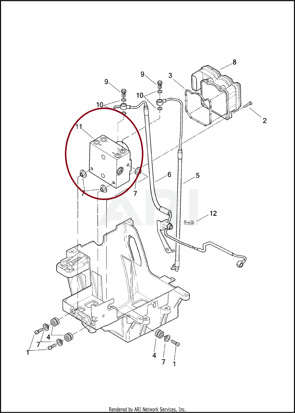

Looks like the unit is available at the Dealer, don't know how long the lead time is for getting one. Not inexpensive though.
Ref:11
48343-09A
CONTROL UNIT,ABS HYDR,SERVICE,FLT
This part replaces 48343-09.
Price: $734.99
