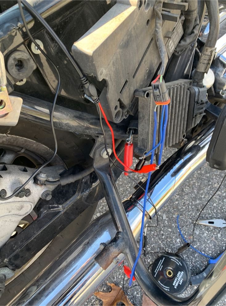

I found a way to add miles to a used gauge on the bench for a LOT of touring models (and cruisers). Video attached to show functionality.
Scenario: You replace your speedometer with a used one, but the mileage on the new gauge is lower than true mileage. You have a bike that is not mileage exempt, and you want to make sure the odometer is accurate.
Solution: Use a $25 signal generator off of amazon. Put your bike on a battery charger, Disconnect the speed sensor, and connect the positive lead to the signal wire (white) at the speed sensor harness (female side), connect the negative lead to the ground wire (black) on the speed sensor harness (female side).

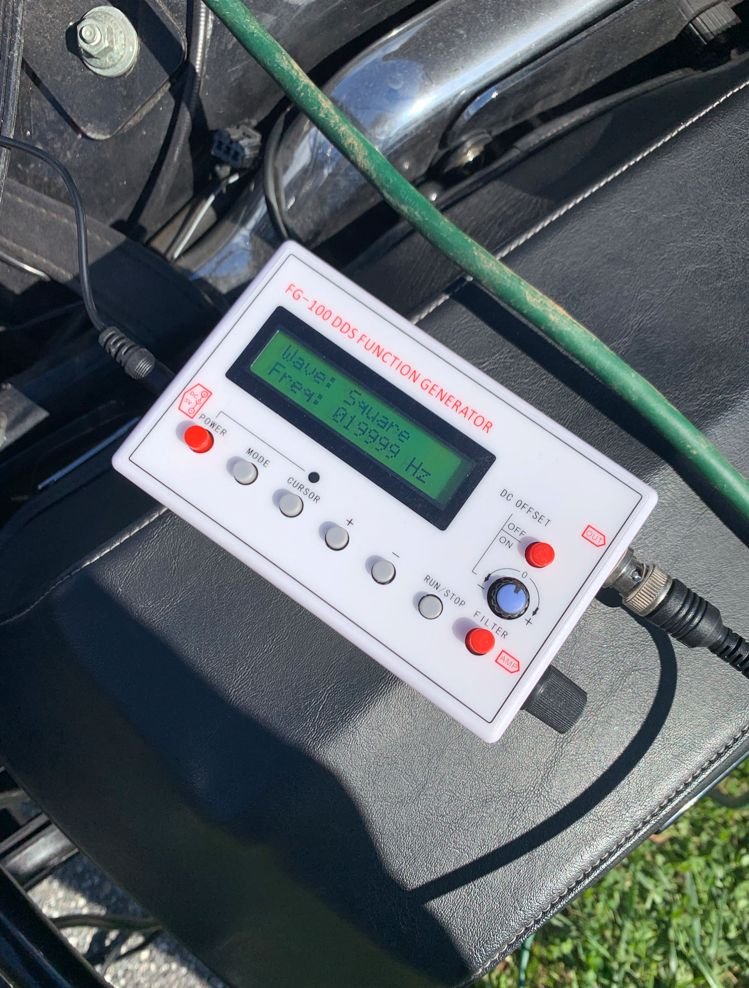

Set the signal generator to square wave, and set the frequency to 22,800 Hz (any higher and my gauge started resetting). Put your ignition to the "ON" and "Run" position. Start your signal generator. You will add mileage to your bike at around 900 mph. I was able to run the generator at 22,800, but no higher than that; photo shows one of my tests at 19,999 Hz
***This is not for mileage "rollback". You can only ADD miles with this method. This for for somebody who wants to make sure their bike has accurate mileage.

It would be super difficult to mess that up. This method adds 1 mile every 3-4 seconds. I'm averaging close to 1000 mph. It would take about 12 minutes to add 200 miles.
My odometer needed about 36,000 miles added. That's about 36 hours on the machine. I literally let it run over night. It's like smoking a brisket....
