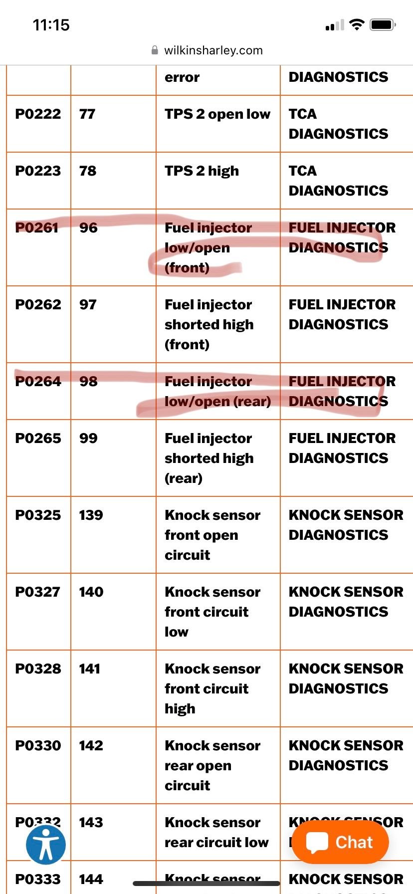

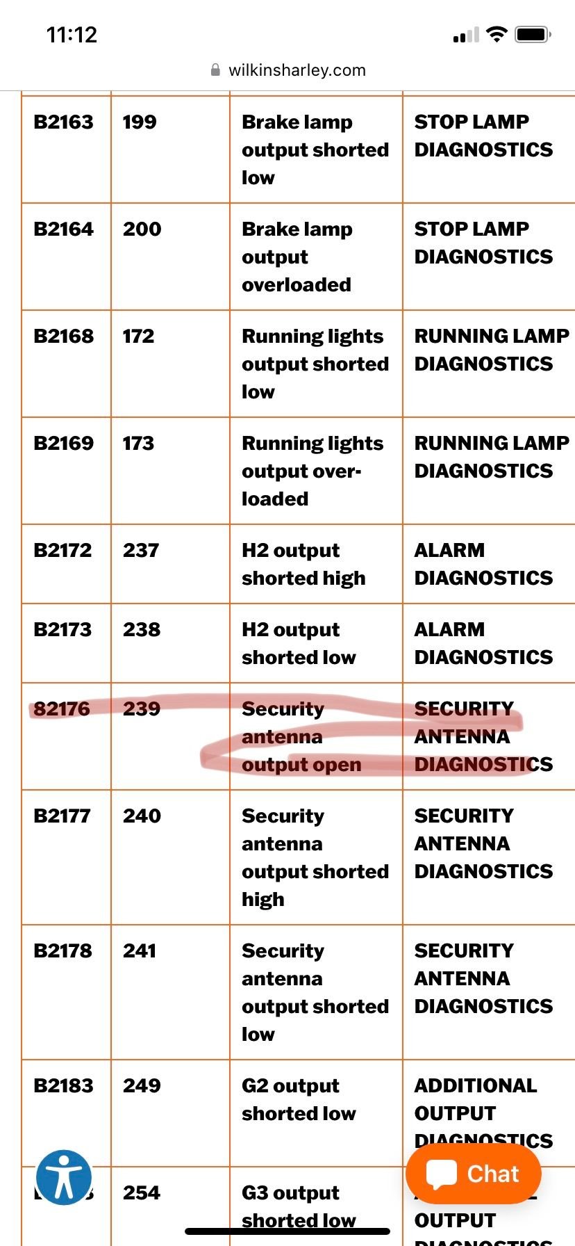

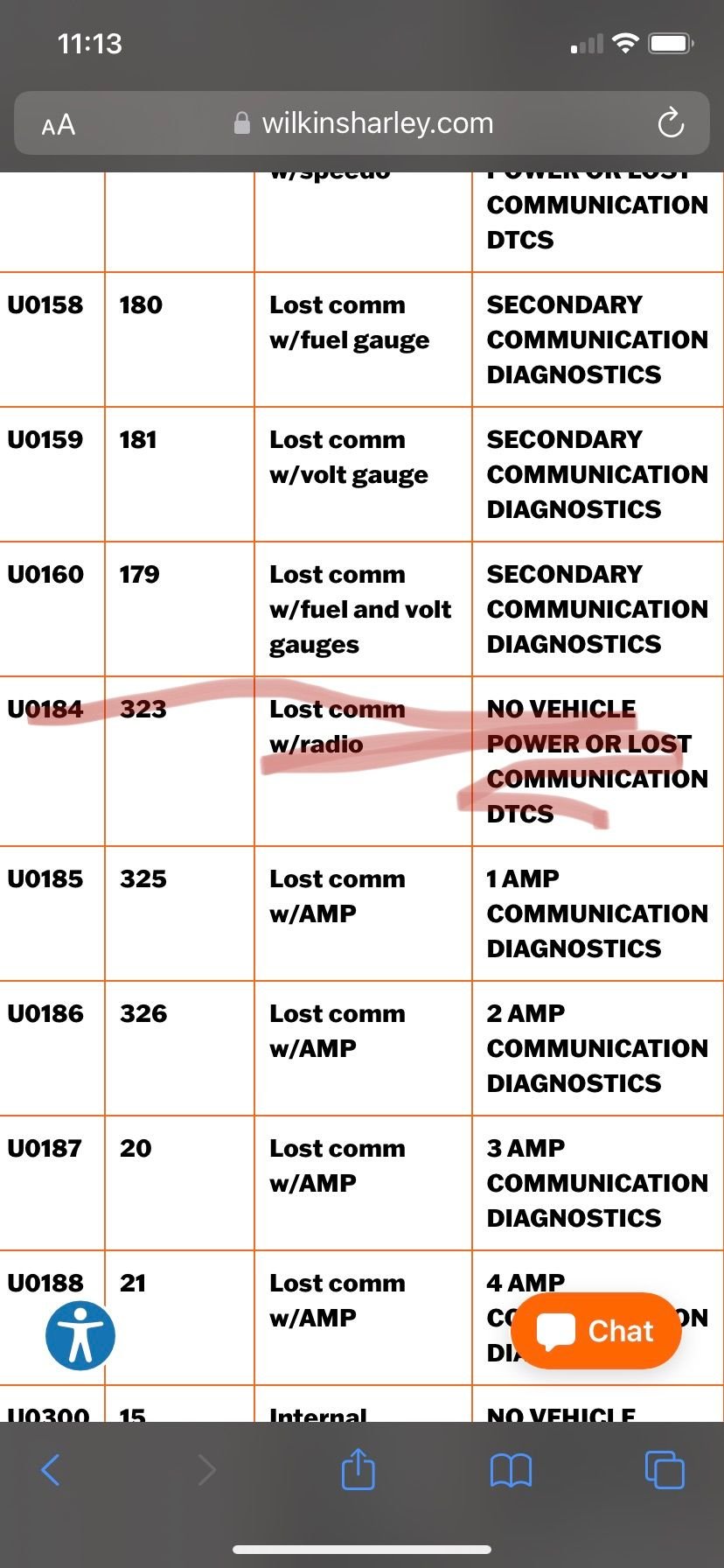

Hey y’all! I recently did some work on my 18 Street glide. I had to unplug a bunch of stuff to take the rocker covers. Now I have 13 codes. Could the codes just be from me unplugging and replugging everything? The codes are PO261, 264, 523, 1655, B2116, 2133, 2141, 2146, 2151, 2156, 2176, 1213, and UO184. Thank you!

Yes they can, clear the codes and see if they come back, hopefully they don't. Also, in the future remove your main fuse when working on the electrical.

cleared the codes. Nothing came back on! Appreciate the advice! Thank you
