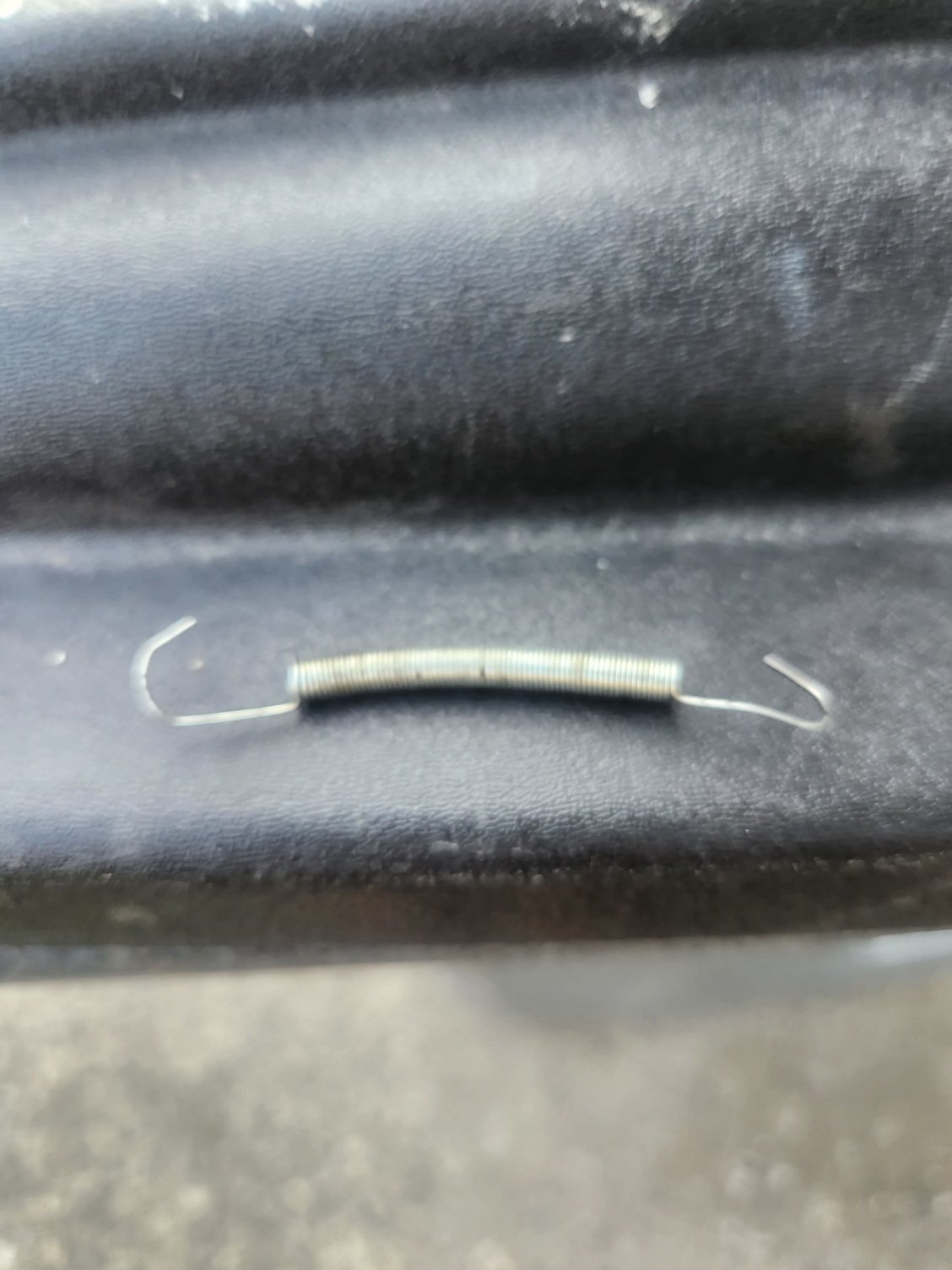

Name this spring 😁
I was doing an oil change on my 2015 Street glide special with a 103 and I found this spring right below the oil cooler any ideas where it goes? Any input would be appreciated.

Heat shield retaining spring.........
Look for the missing one where there are 2 little holes in the heat shield.

You are 100% correct thank you very much
