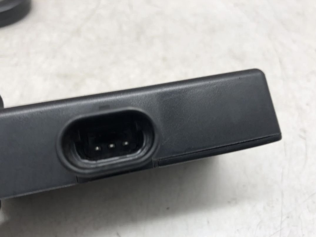

Hi guys. Total HD noob here 🙄
I've been trying to start this beautiful bike for over 6 months now. I bought it at the police auction with no keys or fob. It's a beautiful 2007 Dyba street bob. The bike wouldn't start. The key slot looks to be factory blanked out so I'm guessing there never been a key for it.
Luckily I found the previous owner who told me they removed the TSSM all together and he got rid of the fob and instead they installed TSM. And in order to start the bike I'll need to get a TSSM with a siren and fob (as one set all programmed to each other). I did buy a second hand set following the part number given by my local HD dealership 68925-07. I've connected the TSSM to one plug (TSSM has 2 sockets but no other plug fits in the 2nd socket). I can't connect the siren as the plug I have at the bike is slightly different to the siren socket. When I try to start the bike nothing happens. I'm assuming it won't work without the siren connected as it's the siren what talks to the fob, correct me if I'm wrong?
How do I start this bike? Shouldn't there be a cable connecting the siren to the 2nd socket of the TSSM?

Thanks. I thought so too. The speedo has power, lights, horn, indicators are on, but nothing happens when I try to start it. Checked the fuses earlier on - one 15A was blown (Speedo fuse). Other fuses appear to be ok, a bit corroded but not blown.

​​​​​No, the bike doesn't turn over. The speedo goes on when power is given from 12v.
with TSM plugged in the hazard lights are flushing
With TSSM connected the indicators don't flash
Any suggestions would be highly appreciated 👍
