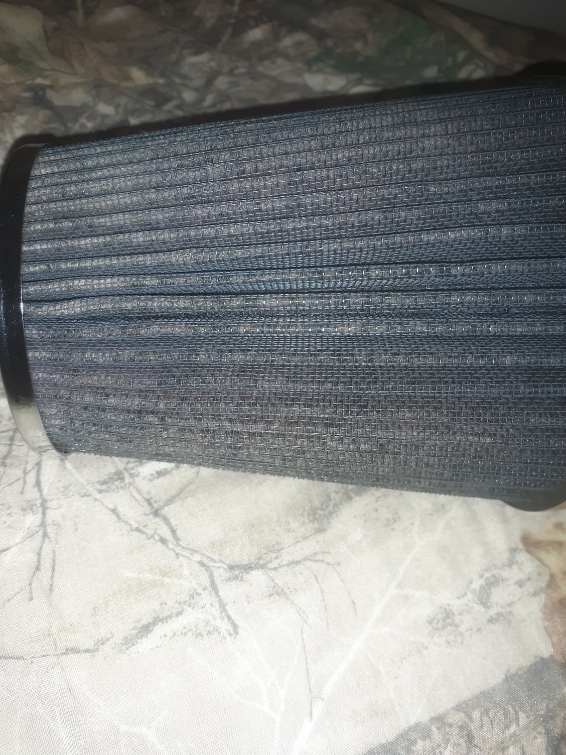

I have the screaming eagle heavy breather on my road king.
I can't find any part number on the filter. How do I know if it is one that needs to be oiled after cleaning or not?
Thanks

Do you know for sure it's not one of the dry filters that HD used to sell? The filter media looks a like a dry filter. The dry filters have a thicker, tighter woven media than the cotton gauze filter that requires oil.

What is the part number for the air cleaner assembly? Take it off and look for the part number. Then search that.
The filter in your picture looks blueish. Did Harley ever use a blue filter?
What year and model bike is it on?
Does the inside of the filter feel oily?
Spray a lite mist of water on the inside, does it get absorbed or bead on the fabric?

Thanks guys.
It's on a 01 road king.
The intake was on the bike when I got it, so I dont have instructions on it.
I cant find a part number anywhere on the filter.

I'd think the chrome endcap is removable and the number is embossed on the rubber

yeah, I've tried to pry on that end cap some, maybe its glued on.

I mentioned it before, take the air cleaner off of the bike. Look for a part number for the air cleaner. Or, how about a picture of the air cleaner assembly.
