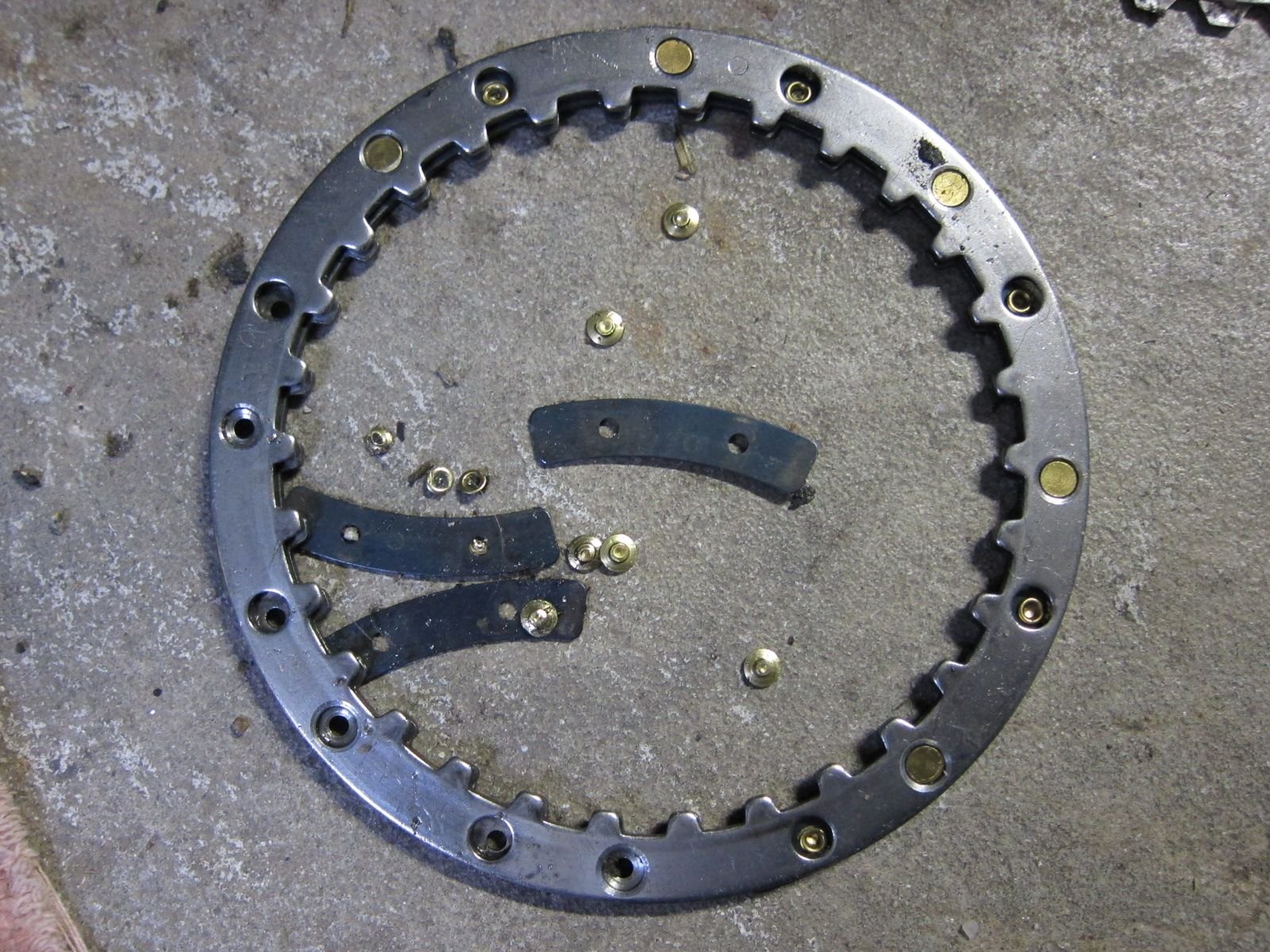

If the bike has a spring plate (AKA grenade plate) in the clutch it would be a good idea to get rid of it, if they come apart (and many have) they do serious damage to the clutch basket, plates, etc.
If I knew what that was it might be a debateable topic.
