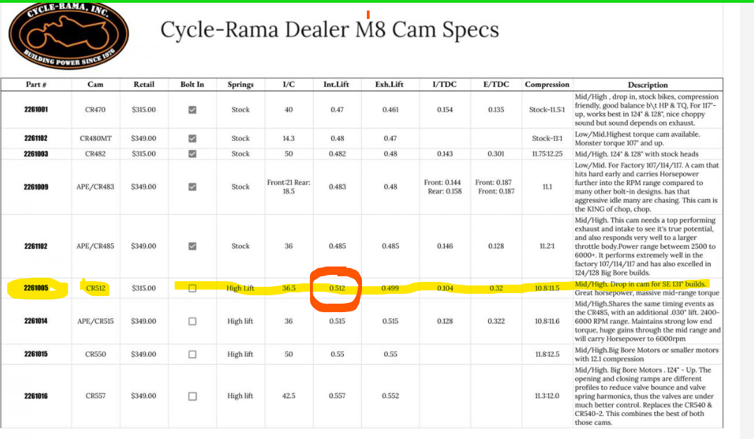

I have the RS468 in my 128, and it is similar to your grind, and after 4 years, I want to ride more north of 3000. Do not get me wrong, this thing has been a beast, and I love it. I just want to use more of the range, and shift things to the right a bit.
I have a CR512 ready to install.

Originally Posted by NorthWestern
I get it.
The fact that you have a 128 to start with is way more than the op has. And the CR512 needs more than just a drop in .... needs new springs. Not exactly an easy task. Certainly some can. Or a shop can.
Um...thanks? I am sorry, did I say something wrong? I was not pushing my cam choice on him, but saying that I understood.
I am well aware what parts I needed, and I do have them all. Never once said it was a drop in cam choice.
