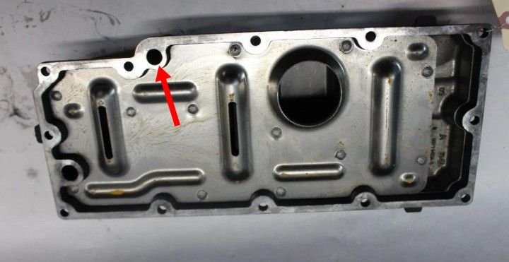

Originally Posted by 470004
On my 2013 SG, the pan under the tranny hold the engine oil and tranny fluid.
Your pan doesn't hold transmission fluid. There is a tiny amount of transmission fluid in the passageway between the transmission and the transmission drain plug. The majority of the fluid is in the transmission.
Here's a pic of the passageway with the baffle removed.
