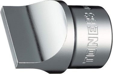

I find that I need a drag link socket to service my hydraulic lifter/tappet filter.
What brand of drag link do you recommend?
What is the width of the blade necessary?
What length of blade is best?

FWIW ... A quality large screwdriver with a hex fitting on the shaft or a hex shaped blunt tip chisel may do the trick along with a wrench to fit the hex if you are in a pinch

And then replace that stupid design with an Allen or hex head. Colony makes replacements.

I just use a 3/8" drive x 1/2" Slotted Bit Socket. I believe I purchased it at one of the larger chain auto stores.
Something similar to this.
https://www.tekton.com/3-8-inch-driv...ed-bit-sockets
Or you can pickup something like the Motion Pro Tappet Oil Filter Screw Plug Tool for HD.

While not exactly what you asked for:
PITTSBURGH1/2 in. Drive Screwdriver Bit Socket Set, 6-Piece
