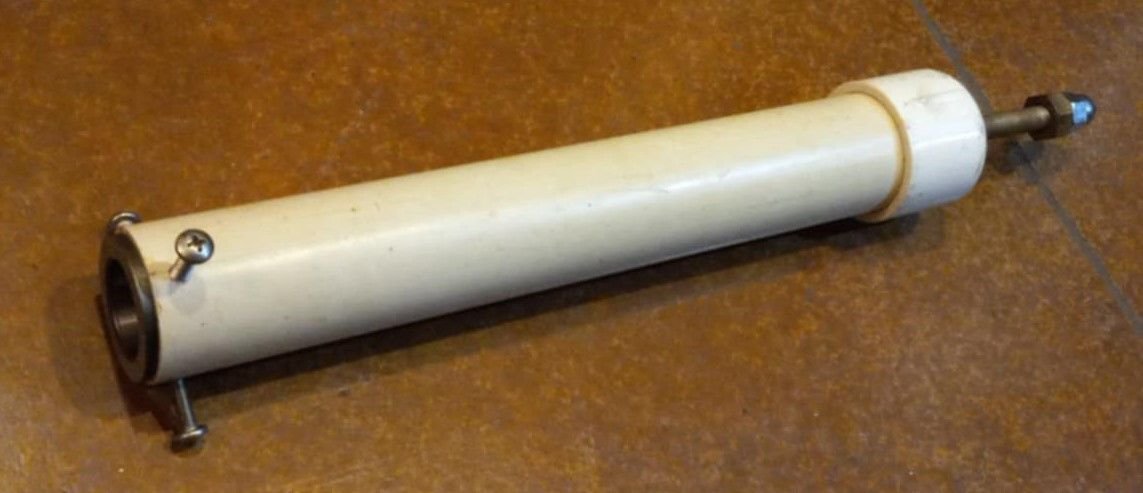

made this and it worked perfectly.
the bearing arent really on that tight, but tight enought you cant just pull them off.
so this bad boy popped it right off.
quite proud of myself.

So that device removed the inner race in the frame?

The inner race is on the stem, which is the part the OP`s tool was used for.
The outer race is in the frame, on later model bikes there is a notch in the shoulder in the frame, so you can drive the outer race out with a drift.

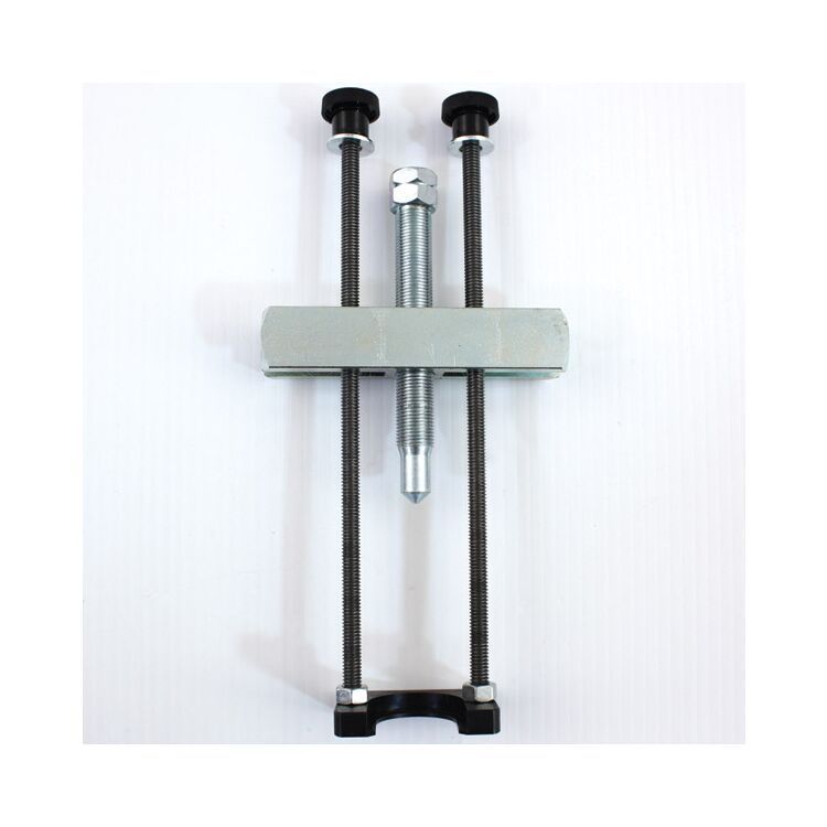

Looks similar to the Motion Pro Steering Stem Bearing Tool.
Good job!

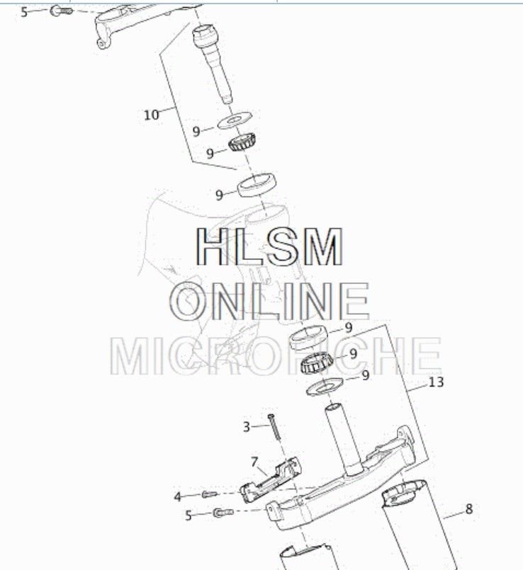

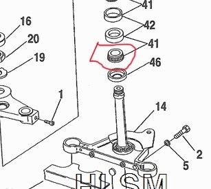

this is "pressed" onto the stem:
after you cut the cage off and remove the rollers, i pulled it off with my plastic pipe.
this is $77
