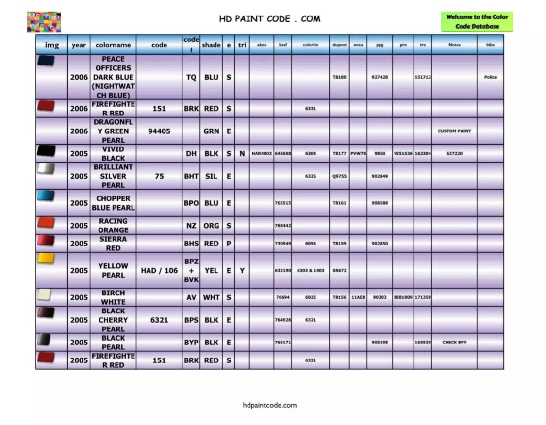

How do I figure out what Harley Davidson has officially named the color Red paint that used on my 2005 dyna wide glide?
I need to replace the front fender on my 2005 dyna wide glide.
To be able to search for a used fender that is already painted the same red,
or if I have to paint a fender to match the bike.
I need to actually know what red Harley calls it.
Thanks

https://www.hdpaintcode.com/complete...code-database/

IIRC, Lava Red Sunglo. Check out the ColorRite Motocycle Paint website. They match and sell HD paints to match OEM; some colors required an undercoat to exactly match the OEM color.
EDIT: GTG beat me to it but confirms Lava Red Sunglo.

Harleys list. LINK

2005 Harley-Davidson FXDWGI Dyna Wide Glide specifications and pictures
Color options according to Bikez.com:
ivid black, brilliant silver pearl, sierra red pearl, chopper blue pearl, lava red sunglo, glacier white pearl, rich sunglo blue, two-tone rich sunglo blue and chopper blue pearl, two-tone sierra red pearl and brilliant silver pearl, two-tone smokey gold
