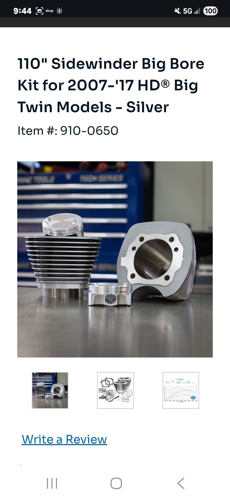

I was wondering if anybody knew if there was a way where I could get a custom order 110 big bore kit for an 07 to 17 twin cam.? I want to get one with all black non-machine fins to match my Harley crossbones. S&S no longer does custom order work. I had ordered a 106 kit from them years ago with all black non-machine fences, but they will no longer do it. I know Harley Davidson has their own screaming eagle big kit and there’s the brand “V twin“ but I haven’t had any luck tracking down a way to do a custom order. Any help would be appreciated thanks.

Do they offer the kits in just the silver gray finish?
If they do you could always have the cylinders powdered coated.

That was my original idea. But S&S said it could warp the bores and of course void any warranty.

I think they are full of it, if that's the case then we all got warped bores.
Harleys cylinders run hotter than what it takes to cure powder coat.

You’re probably right. Just just don’t wanna go through all the hassle and have a problem. If I can’t get a 110 kit with non-machined fins then I’ll probably just go with a bored out 107 kit in all black.
