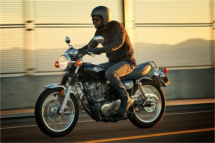

Man When you say SR all I can think of is my buddies REAL SR:
Awesome bike BTW.
