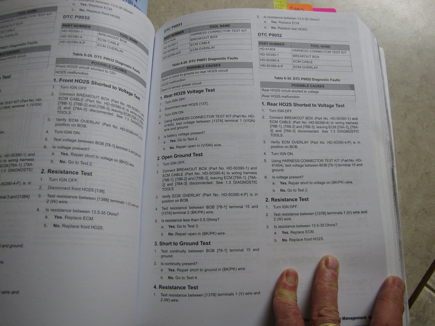

After swapping my exhaust, AC and adding a VH Fuel Pak, my 2015 SGS is giving the error code P0051. I know it has to do with the rear O2 sensor. Ive checked the cable and it looks good but I know they are easily broken. Before I go dish out 60 bucks for a new cable is there possibly something I am missing?

Hope this helps:

Thank you
I broke and bought a new one. Ended up being the problem. Guess they are as sensitive as they say
