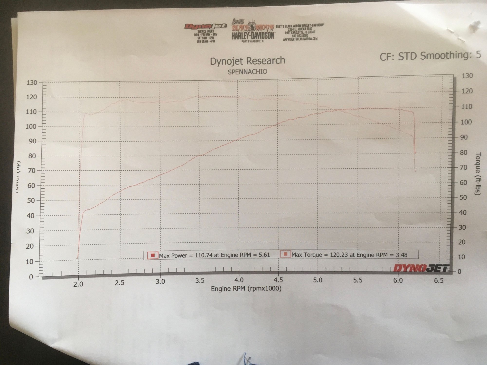

I'd think with a Torque cam, you would have power down low like at 2000 rpms. But its a EPA compliant cam, so... maybe try a better cam. Here's my dyno sheet Red Shift 468, Power Vision (tuned at dealer) with stock exhaust.
