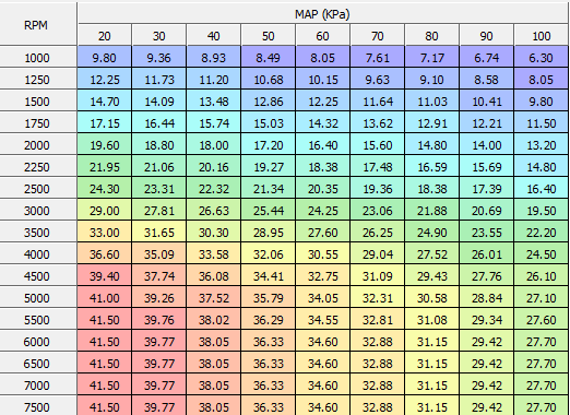

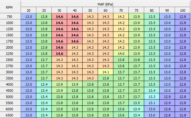

I'll post what Aaron Wilson from Hammer Performance sent me when I went from 883 -> 1250.
You should not use 80ci as your displacement however, use something like 78 (yes, even this is a little large).
The timing for a 1200 is less aggressive than 883. I would highly recommend going to the Hammer Performance
website and reading all of the information they have available (there is alot).
On Mastertune, enter this timing map, or a reasonable facsimile, for both cylinders:
Yes, set the displacement to 80. If you do these two things, it will be safe to run.
Optionally, set your AFR table like this, we've found it runs better than the factory AFR table which is way too heavy on the closed loop stuff:
One you're 20 miles or so into the gentle break-in, run your first Vtune session.
My Iron runs great. I still have not changed any timing values. I need to get it to a dyno....
hope this helps,
T.

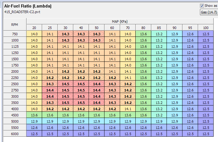

sound advice overall, however I would do more closed loop on the 'cruising' portion of the AFR, which for a sporster is 2250-4000 and keep it open loop under 2000 (except for idle). something like this :
