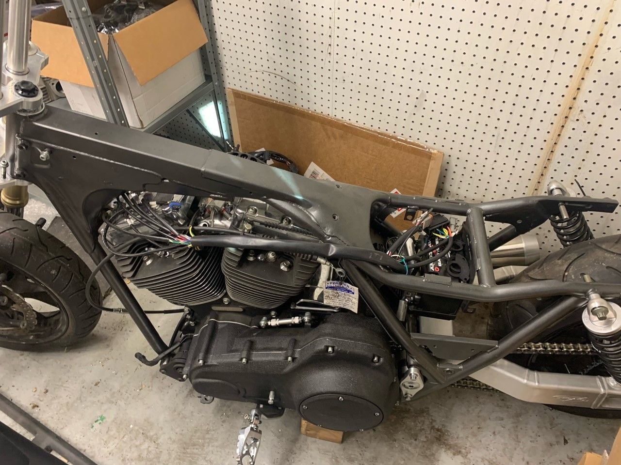

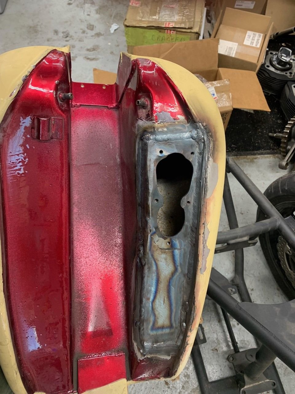

I have converted a few bikes from carb to EFI. Thayer use to make wire harnesses. Don't know if he still does. These harness are for the earlier Delphi bikes. So picking a TB that works is important. I like dyna ECM's that will take level 176 cals but I have mostly done FXR's and Dyna's. There are plates that can be welded into tanks for a XL style pump. I jump the pins that are suppose to go to the TSM or TSSM. Having a pretty good handle on EFI and what difference are out there from model to model is a must. Even simple things like there are two different IAC motors out there. One is pinned out as 1,2 are a pair and some have 1,4 as the pair for the stepper motor.
Here is one I am doing for my brother. He is a traveling tradesmen so we work on it together when he is in town. 2010 bagger drivetrain.

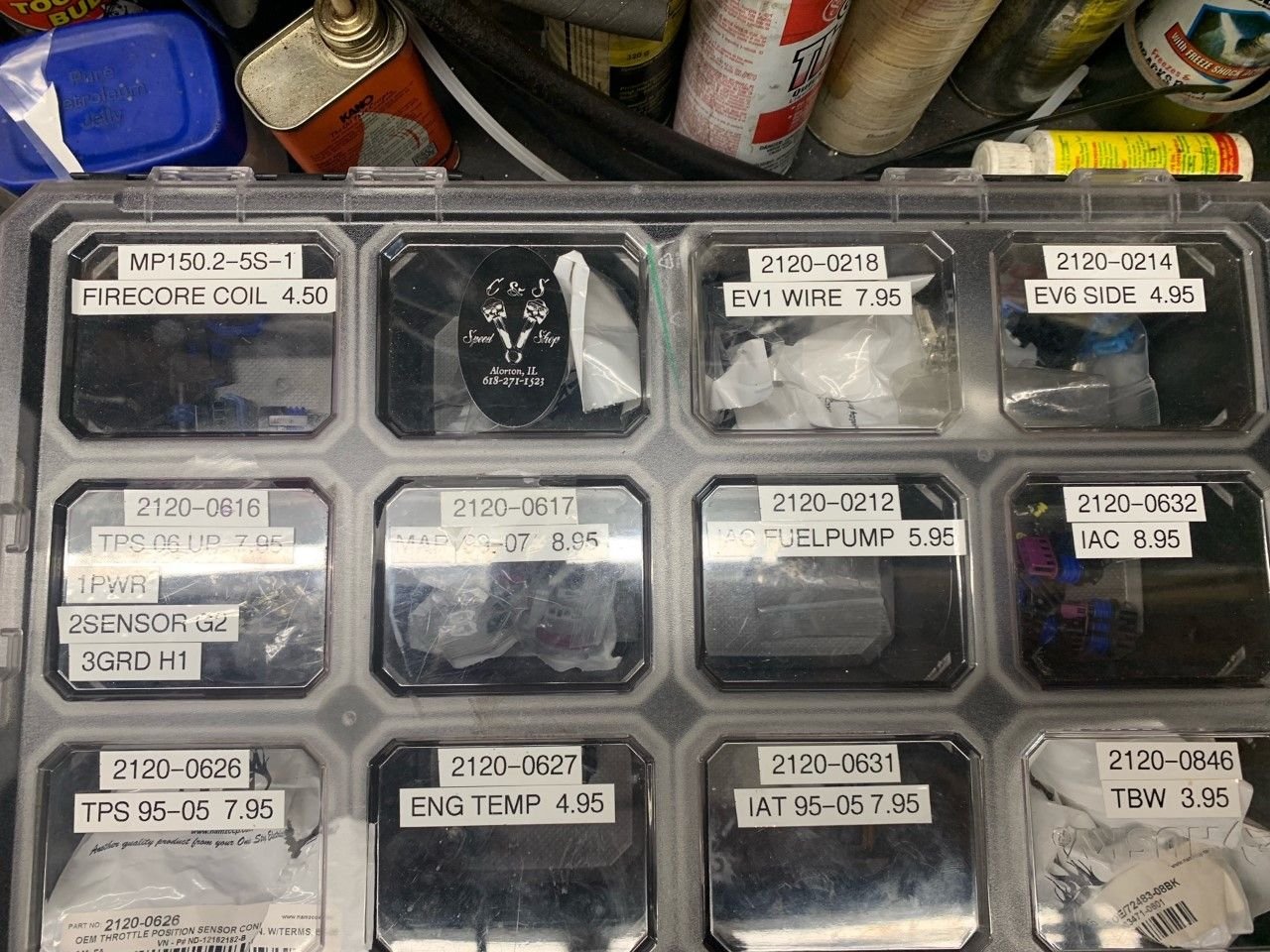

You can also buy all the connectors and make your own wire harness. These are NOT special HD sourced connectors. They are basic connectors that are all over GM and Fords. Single retail price for connector and pins in on top of the box along with DS part numbers. The expense is buying a decent set of positive release crimpers.
