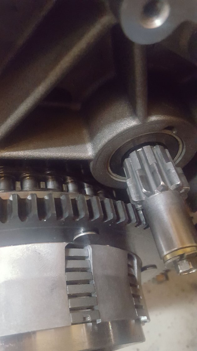

This is with the jackshaft screw all the way in. somethings or right.
Can anyone help? 2001 RK. Stock starter, nothing new.
This is before I removed it.

Got it. deep side of coupling is where the spring goes.
