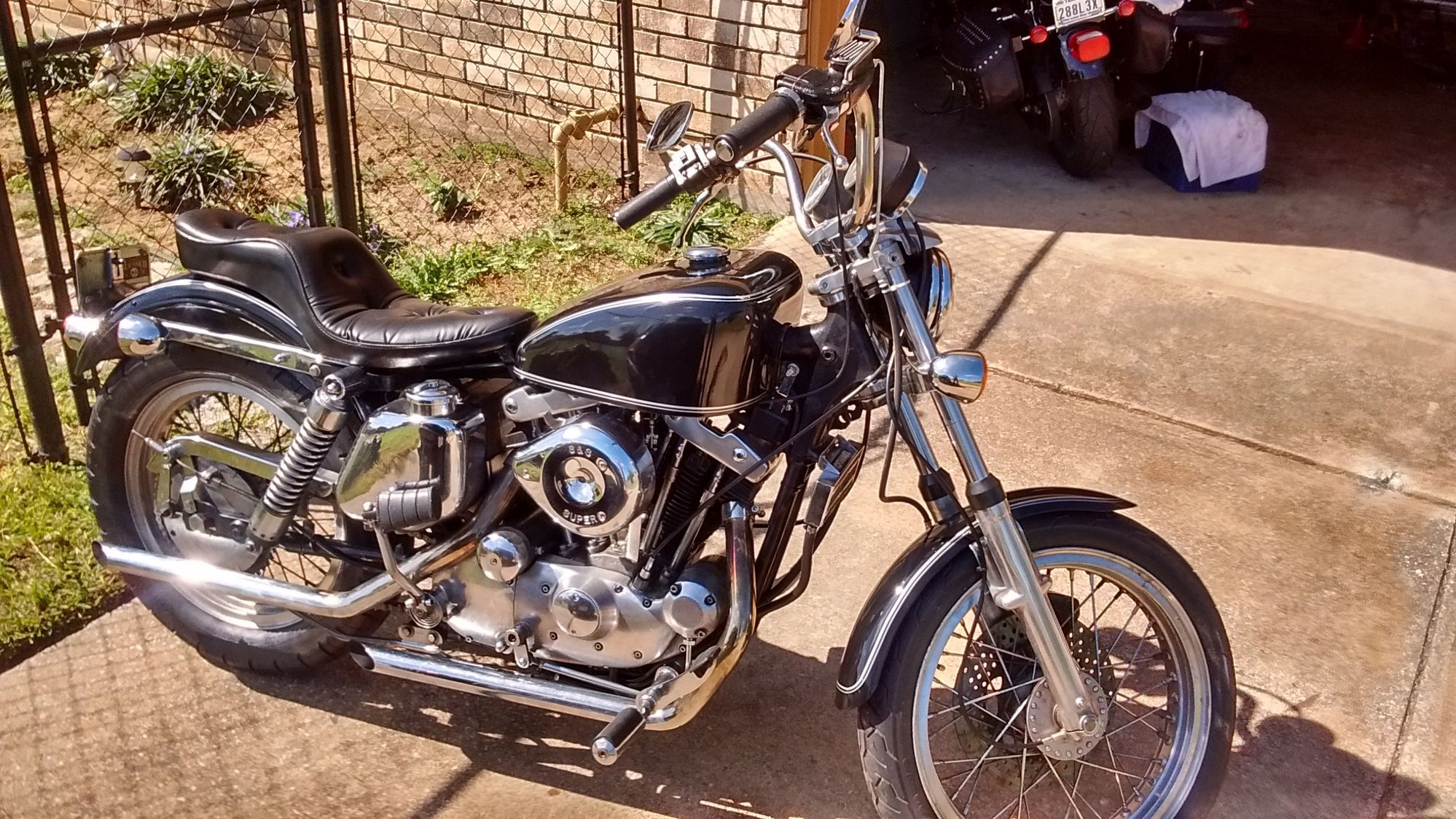

It's a long road to get there but well worth it. Took me 3 1/2 years to restore my 77 XLH. The only work I farmed out was cylinder boring, valve seats & valve guides.
