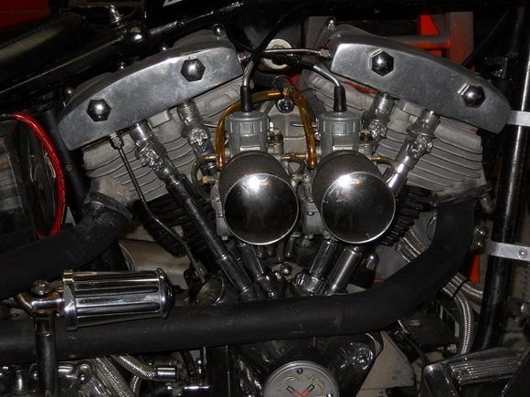

Thanks very much for all the information--really great stuff, as I think that if indeed I do the dual-carb shuffle, I will use your X-head setup. Very cool!

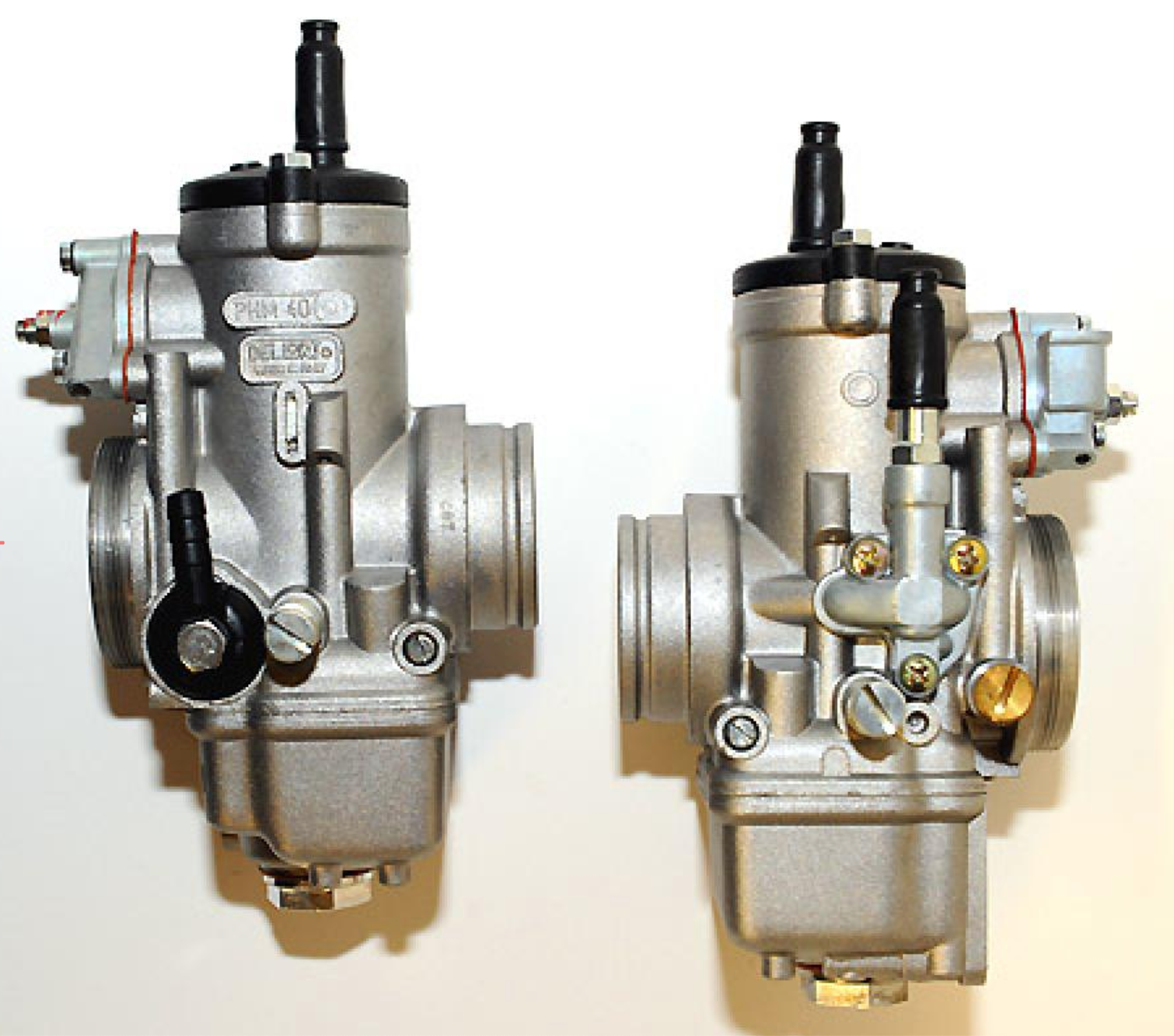

On the carbs: I have Mikunis, though smaller and jetted for the 650cc power plant, on the '71 Bonny (in the photos in post no. 21 and 27, there were still Amals, sold to buy the Mikunis and a filet mignon to cook up for Sunday dinner). The Mikunis' attachment appears to be identical to the Dellorto 40mm, shown here. (These show the cable-operated choke, but you can get them with the 'flip lever' chokes, too.). Dellorto sells short 'manifolds' which have molded grooves to match those on the carb body casting. However, the 40mm Bings on my old BMW 1,000cc just used what appear to me to be slices of fuel-filler hose, and after being clamped on for a while grooves formed in the rubber.
Now, I should say that I need to measure the length and width of comparable Mikunis, as they appear to be far cheaper than Dellortos. The main difference appears to be that the Dells have an accelerator pump. But I also need to find out the availability of tuning parts for Dells, as Mikunis have a vast array of needles and jets available.
Manifolds: okay, good info on the runner length as extrapolated from plenum volume. As I've said--and I'll have to dig this up--there is extensive data people have compiled on intake runner length (and by implication, volume) and torque at [x] rpms. I know that Vizzard, the author of the definitive A-Series hot-rodding 'bible' did flow bench studies using various carbs, including dual-throat Webers--which on the A-Series meant one runner per carb throat but merging into two intake ports on the weird 'siamese' A-Series head. That's a whole other discussion due to valve timing and one cylinder 'robbing' the intake charge from the adjacent cylinder via the siamese port--and which wouldn't apply to a one carb-per-cylinder Sporty setup.
But the runner length impacting torque output at [x] rpms would apply. So, I'll bone up on this (the old slant 6 American auto engines used long runners to good effect, as did the 2,000 Toyota Camry 4-cylinder, etc., etc...). At any rate, as you point out, two carbs may be a wash re: ultimate performance, but that isn't the primary criterion for this project--and especially in view of your experience with the dual carbs at least not being counter-productive, the other criteria which do matter to me may favor trying this out.
Those criteria are: (i) maximizing narrowness of the V-twin engine & netting knee-to-tank riding posture (I hate the R/H bow-legged posture); (ii) having a unique Ironhead hot-rod; (iii) novel tinkering/fabrication challenge.
Finally, I'm thinking that I'd use short rubber pieces to connect the carbs to aluminum runners, and to connect the runner to the head's intake port. This could produce several benefits. First, I could weld mounting tab onto the runners, so they would be relatively solid and stay in place (with loctite, of course!). Second, fabricated aluminum runners means I can position the carbs in optimum position for criteria no. 1 above. Third, I can sand (and if I wanted to, polish, powder coat, or...?) the aluminum runners to match whatever aesthetic the bike ends up with. Fourth, I could also run a flex hone through the inside to produce a really nice flow.
