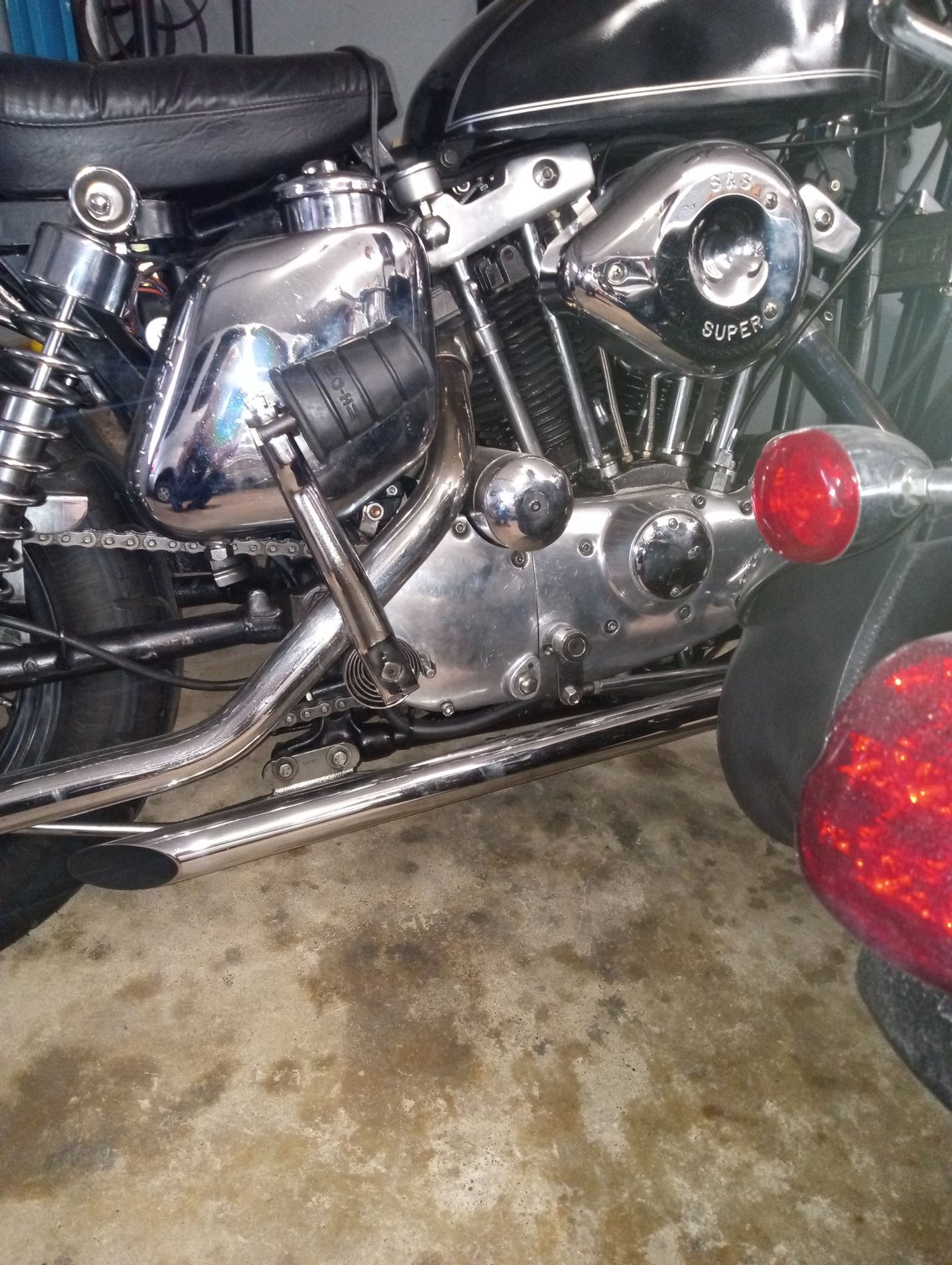

We can fix small and old a little bit. I'm 75 with a 77 XLH 1000, kick & electric start. I've been relying on the Magic Start button for few years now. Recently I found a STROKER KICKARM. 1 1/2 inches longer than OEM. Wisco 10:1 forged pistons, Andrews R5 cams, not good for a kicker.
Well, after 2 mini-strokes, Afib and a triple bypass I can kick it again!

Stroker Kickerarm that I am using is from Drag Specialties, forged steel. The oil pressure gauge is a V-Twin item. Might wanna take a look on ebay and see what pops up.
