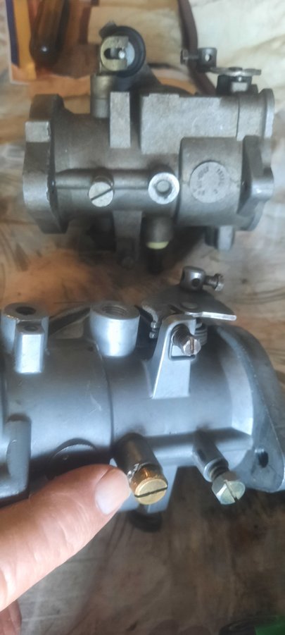

Ron, mine has a C stamped on the head. Second carby is fixed. Does C help you at all? I would imagine that the difference would be in the id, increasing or decreasing the amount of fuel delivered on full throttle . Somewhere I seldom get, so either would probably work for me. Let me know if you need info on the type C. Cheers .

Thanks Mervk, I was thinking that it was more the holes drilled and size of them that was the difference. I have an "A" which has two holes near the bottom and one at the top .

Chatgpt tells me difference is the size and placement of holes with A being the richest, B medium and C leanest. For what it's worth.
