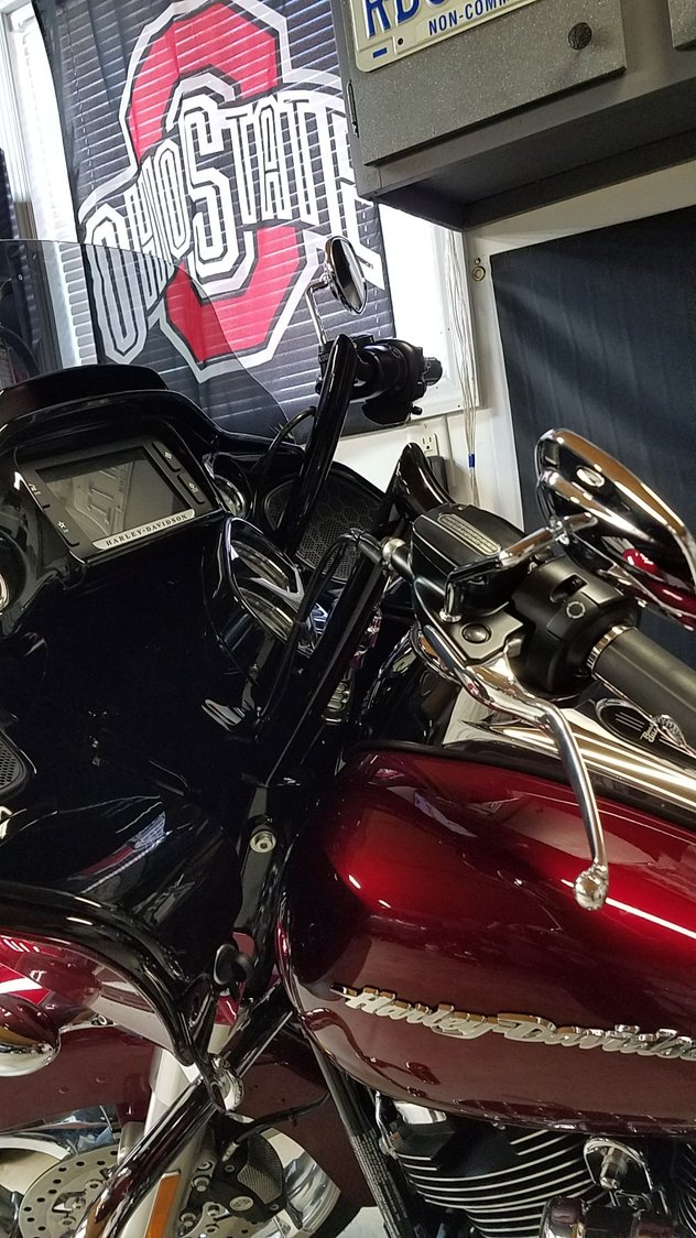

I ended up adjusting my bars but still wasn't enough to make it comfortable when riding for long distances. Ended up changing over to 10" Monkey bars on the glide and am in need of some warm weather to see how they work out!
