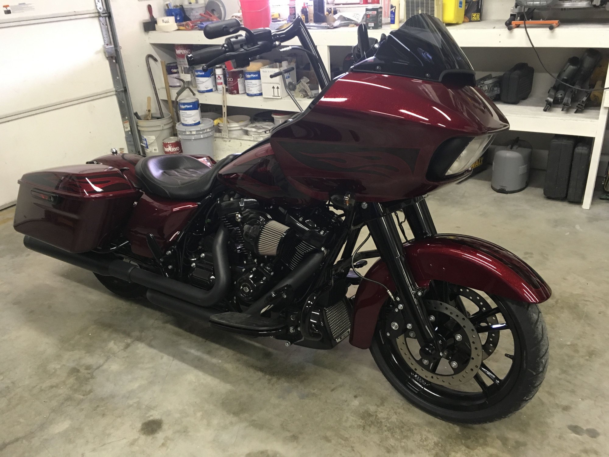

Factory 47 14" with wire extensions and stock cables.

14" Yaffe bars on my 2017 RGS, no changes other than hydraulic lines and wiring
